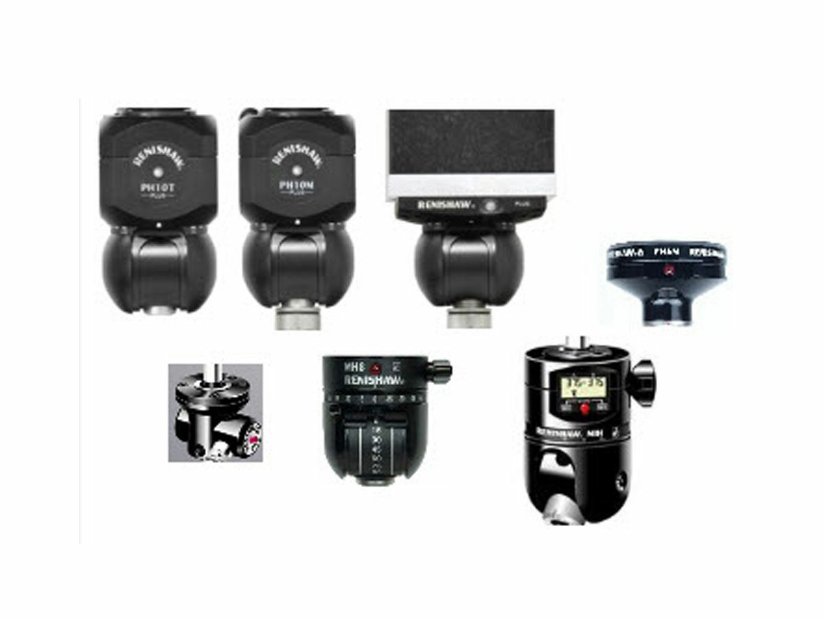

Mitutoyo offers a wide variety of CMM probe heads that support a number of probe systems to enhance the measurements capabilities of Mitutoyo Coordinate Measurement Machines and improve measurement throughput for nearly any type of application.
Mitutoyo offers fixed, manually articulated and motorized CMM probe heads for both manual and CNC Coordinate Measuring Machines. The probe heads support a wide range of probes and styli to take accurate measurements for nearly any type of application.
