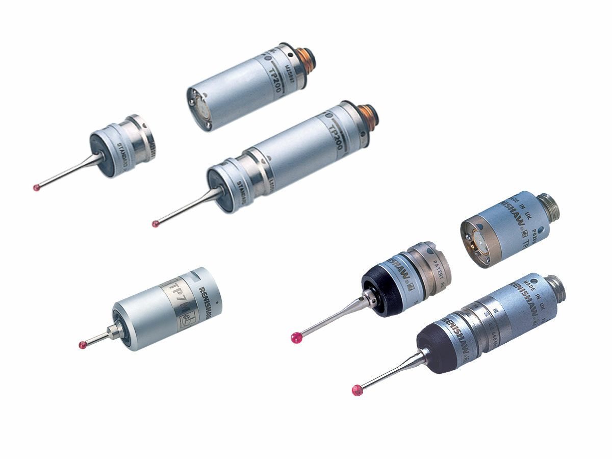

Tactile probes (aka touch trigger probes), are probe sensors that take individual point measurements using various technologies such as strain-gage, optical transducer, kinematic switch.
Mitutoyo offers several different touch probes for manual and CNC Coordinate Measuring Machines. These touch probes are capable of measuring discrete points, ideal for inspecting three-dimensional parts and workpieces. The TP20 and TP200 touch probes feature detachable stylus modules giving users the ability to select the ideal measurement for any application with faster measuring time and better productivity. The TP7 probe is a high-accuracy touch-trigger probe with exceptional repeatability and ability to mount a longer stylus.

| 54AAA993 | TP200 | PH10MQ, PH10M, PH10T PH6M, PH1 | CNC | MCOSMOS | Electronic Strain Sensors | M8 Thread | ±X, ±Y, ±Z | M2 | - | 0.20~1.20μm | *Module/Stylus Specific | 1.9684" 50mm |
| A-1073-0261 | TP7 | PH10MQ, PH10M, PH10T PH6M | CNC | MCOSMOS | Silicon Strain Sensors | Autojoint Connector | ±X, ±Y, ±Z | M4 | - | 0.25~1.0μm (Trigger Level Specific) | *Module/Stylus Specific | 7.8739" 200mm |
| A-1371-0290 | TP20 | PH10MQ, PH10M, PH10T PH6M, MIH, MH8, MH20i, PH1 | CNC Manual | MCOSMOS | Kinematic Switching | M8 Thread | 6-way module: X, ±Y, ±Z / All other modules: ±X, ±Y, +Z | M2 | - | 0.35~0.80μm | *Module/Stylus Specific | 2.3621" 60mm |
