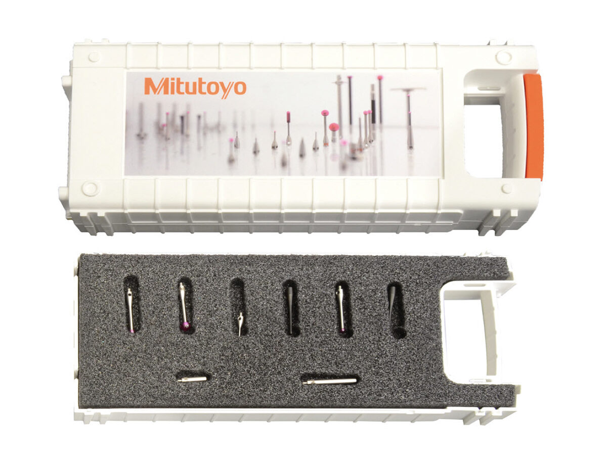

Order No.: | Kit Description: |
Product Image: | Number of Items: |
Kit Components: |
Probe Fitment: |
K651318 | M3 CRP 1 Styli Kit | - | 7 | Ruby stylus-carbon fiber: Ø3xL20mm, Ø4xL21mm, Ø4xL31mm, Ø4xL40mm, Ø5xL50mm, SiNi stylus-carbon fiber Ø4xL21mm, Pin spanner ø1.2mm |
SP25 |
K651319 | M3 CRP 2 Styli Kit | - | 6 | Ruby stylus-carbon fiber: Ø5xL21mm, Ø5xL50mm, Ø6xL50mm, Ø6xL75mm, SiNi stylus-carbon fiber Ø5xL21mm, Pin spanner ø1.2mm |
SP25 |
K651320 | M3 CRP 3 Styli Kit | - | 6 | Ruby stylus-carbon fiber: Ø5xL21mm, Ø5xL50mm, Ø6xL75mm, Ø8xL100mm, SiNi stylus-carbon fiber Ø5xL21mm, Pin spanner ø1.2mm |
SP25 |
K651354 | M2 Basic 2 Styli Kit | - | 12 | Ruby stylus-tungsten carbide: Ø0.5xL20mm, Ø1xL20mm; Ruby stylus-steel Ø2xL20mm steel; Ruby stylus-carbon fiber: Ø4xL50mm, Ø5xL50mm, Ø6xL50mm; Extension-CRP: L40mm, L50mm; Extension-CFK: L70mm, L90mm; 5-way stylus holder L8mm; Pin spanner ø1.2mm |
TP2, TP20, TP200, TP6, TP6A, MH20i, PH20 |
K651376 | M2 Starter Styli Kit | - | 8 | Ruby stylus-steel: Ø1xL10mm; Ø2xL20mm, Ø3xL20mm steel, Ø4xL20mm; Extension-steel: L10mm; L20mm steel; Pin spanner ø1.2mm |
TP2, TP20, TP200, MH20i |
K651377 | M2 Basic 1 Styli Kit | - | 15 | Ruby stylus-steel; Ø1xL10mm, Ø2xL10mm, Ø2xL20mm, Ø3xL10mm, Ø3xL20mm, Ø4xL20mm; Cylinder stylus Ø3xL13mm steel; Adapter L7mm; 5-way stylus Ø2xL30mm; Steel disk Ø18xL7.5mm; Ruby disk Ø6xL10mm, Extension-steel: L10mm, L20mm steel; Pin spanner ø1.2mm |
K651378 | M2 Expansion Styli Kit | - | 20 | Ruby stylus, tungsten carbide: Ø0.7xL10mm, Ø1xL20mm, Ø1.5xL30mm, Ø0.3xL10mm, Ø0.5xL10mm, Ruby stylus, steel: Ø1xL10mm, Ø1xL10mm, Ø2.5xL10mm, Ø2.5xL20mm. Cylinder stylus Ø2xL20mm steel, Steel disk: Ø18xL7.5mm, Ø25xL7.5mm, Extension L40mm, Pin spanner ø1.2mm |
K651379 | M2 Professional Styli Kit | - | 60 | Ruby stylus-tungsten carbide: Ø0.7xL10mm, Ø1xL20mm, Ø0.3xL10mm, Ø0.5xL10mm., Ruby stylus-steel: Ø1xL10mm, Ø1.5xL10mm, Ø2.5xL10mm, Ø2.5xL20mm, Ø3xL10mm, Ø3xL20mm, Ø4xL10mm, Ø4xL20mm, Ø5xL10mm, Ø6xL10mm, Ø8xL11mm. Cylinder stylus-steel: Ø1.5xL11mm, Ø3xL13mm, Ø3xL20mm. Adapter L7, 4-way ruby stylus Ø1xL10mm, 5-way ruby stylus Ø2xL18mm, 5-way ruby stylus Ø2xL30mm, Tip stylus-tungsten carbide L10mm, Steel disk: Ø18xL7.5mm, Ø25xL7.5mm, Ruby disk Ø6xL10mm, Hollow ball ceramic Ø18xL11mm, 5-way stylus holder L8mm, Extension-steel: L5mm, L10mm, L20mm, L30mm, L40mm, Pin spanner ø1.2mm |
K651380 | M3 Starter Styli Kit | - | 9 | Ruby stylus, steel: Ø1xL21mm, Ø2xL21mm, Ø3xL21mm, Ø4xL31mm, Ø5xL33.5mm, Extension-steel: L20mm, L35mm, Pin spanner ø1.2mm |
SP25 |
K651382 | M2 Addition Styli Kit | - | 17 | Ruby stylus-steel: Ø1xL10mm, Ø2xL20mm, Ø3xL20mm, Ø4xL20mm; Extension-steel; L10mm, L20mm, L30mm; 5-way stylus holder L8mm, Pin spanner ø1.2mm |
K651383 | M4 Styli Kit | - | 22 | Ruby Stylus,ceramic: Ø8x50mm, Ø8x100mm; Ruby stylus, steel: Ø1xL19.5mm, Ø2xL19mm, Ø4xL18mm; Adaptor ceramic: M4/M3 L50, M4/M3 L75; Adaptor steel: M3/M2 L5, M4/M3 L9, M4/M3 L100; Extension ceramic: L30mm, L50mm; 5-way stylus holder: M2, M3, M4; Pin spanner: ø1.2mm, ø1.7mm |
MPP, TP7 |
