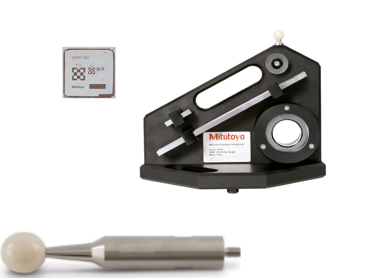

Quality control depends on constantly maintaining maximum accuracy performance of a CMM. This requires regular verification of styli as well as the CMM itself by using only Mitutoyo certified artifacts.
Verification Artifacts
| Order No.: | Kit Description: |
Product Image: | Number of Items: |
Kit Components: |
| 02AKN020 | Calibration Chart | - | 1 | Used in conjunction with the Quick Vision Probe (QVP) for pixel calibration. |
| 06ABM944 | Ø20mm Masterball | - | 1 | Used for CMM probe stylus verification. |
| 515-763 | Check Master 0-1000mm | - | 1 | High Accuracy Ceramic Block, ±2.5 µm Accuracy, 1.5 µm Parallelism. Each measuring block is made of zirconia-based ceramic that requires no anti-corrosion treatment for measuring faces. |
