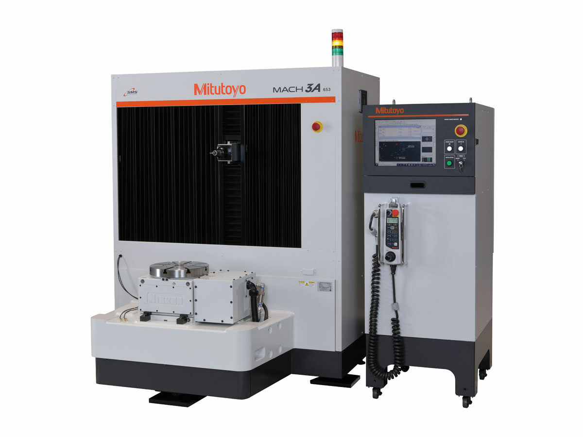

The MACH 3A CNC CMM is designed for 24-hour operation. This CMM achieves high throughput by increasing drive speed, acceleration and measuring speed, making it one of the fastest horizontal CNC CMMs on the market.
The Mitutoyo MACH-3A horizontal-type CNC Coordinate Measuring Machine incorporates the CMM controller and host computer in the main unit resulting in a compact, space-saving footprint on the shop floor. The unit’s all-in-one, superior structural design allows for stable around-the-clock operations with dust resistance, making the MACH-3A CMM highly reliable for measurements on the production line.
- World class acceleration, measuring speed and drive speed contributes to total cost reductions as an auto-measurement system
- The horizontal-axis design allows this system to use the same workpiece handling and routing as the processing machines use
- Improved structural design, air-free operation and incorporated control unit and PC reduces maintenance
- Temperature compensation guarantees accuracy within 4 different ranges: 66.2~69.8°F (19~21°C), 59~77°F (15~25°C), 50~86°F (10~30°C), 50~95°F (10~35°C)
