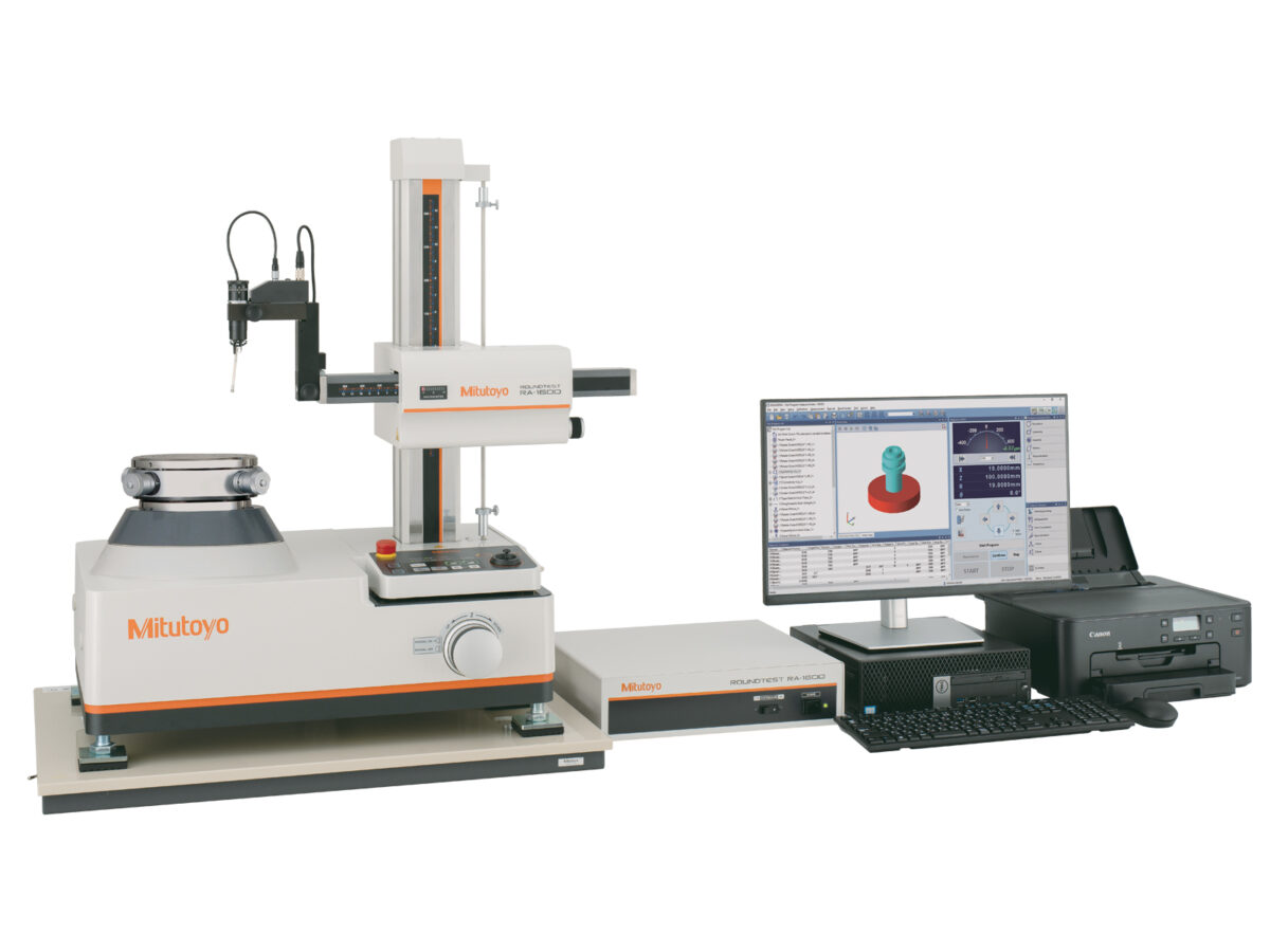

Roundtest RA-1600/RA-1600M
The  RA-1600/RA-1600M roundness/cylindricity measuring system performs powerful roundness and cylindrical analysis with the highest precision level in its class.
The RA-1600/RA-1600M roundness/cylindricity measuring system is PC-compliant and is equipped with extensive analysis features for both the shop floor and laboratory environment. The unit’s highly accurate and easy-to-use turntable enables simple, reliable centering and leveling on a wide variety of workpieces.
  • The spiral-mode measurement function combines table rotation and rectilinear action allowing cylindricity, coaxiality and other measurement data to be loaded as a continuous data set
  • Built-in X-axis linear scale makes measurement while tracing possible when displacement due to form variation exceeds the measuring range of the detector, and X-axis motion is necessary to maintain contact with the surface of the workpiece
  • Enhanced detector safety functions, such as accidental touch and collision detection, minimizes damage to both machine and workpieces
  • Analysis results such as cylindricity and coaxiality can be visually expressed in 3D graphics
  • Continuous OD/ID measurement is possible without changing the detector position
  • High rotational accuracy (0.03+6H/10000)μm is maintained for an entry level to mid-range model
  • PC-based cylindricity capable Roundtest for both shop floor and laboratory environment
  • Simple easy to use center and level function with mechanical mic heads on alignment table
  • Accidental touch function disables the movement when the detector goes over range
Bearing Type: Air
Rotating Speed: 10, 4, 6rpm
Table Diameter: 5.9" / 150mm
Table Centering Range (With DAT function): ± .12" / ± 3mm
Table Leveling Range: ±1°
Max Table Loading: 55lbs / 25kg
Table Max Probing Diameter: 11" / 280mm
Table Max Loading Diameter: 22" / 560mm
Column Traverse Method: Motorized
Column Measuring Speed: .5, 1, 2mm/s
Column Traverse Range: 11.8" / 300mm
Column Max Probing Height: 11.8" / 300mm
Column Max Probing Depth: (Over ø1.26) 3.6" / (Over ø0.27) 1.97" / (Over ø32) 91mm / (Over ø7) 50mm
Radial Traverse Method: Motorized
Radial Traverse Range: 6.5" / 165mm
Radial Drive Speed (Max): 8mm/s
Radial measuring speed: .5, 1, 2mm/s
Detector Measuring Force: 10 to 50 mN
Detector Stylus Tip: Carbide ball diameter .06" / Carbide ball diameter 1.6mm
Standard Detector measuring range: ±4, ±40, ±400μm
Follow Detector measuring range: ±5mm
Detector Measuring Direction: Bi-directional
Stylus Angle Adjustment: ±45°
Data Sampling Points: 14,400/rev
Air pressure: .39 Mpa
Main Unit Dimensions: 35 x 19.3 x 33" / 890 x 490 x 840mm
Main Unit Mass: 375lbs / 170kg
Order No.: Product Image: Table Adjustment Method:
211-724A Analog mic heads
211-733A Digimatic mic heads
