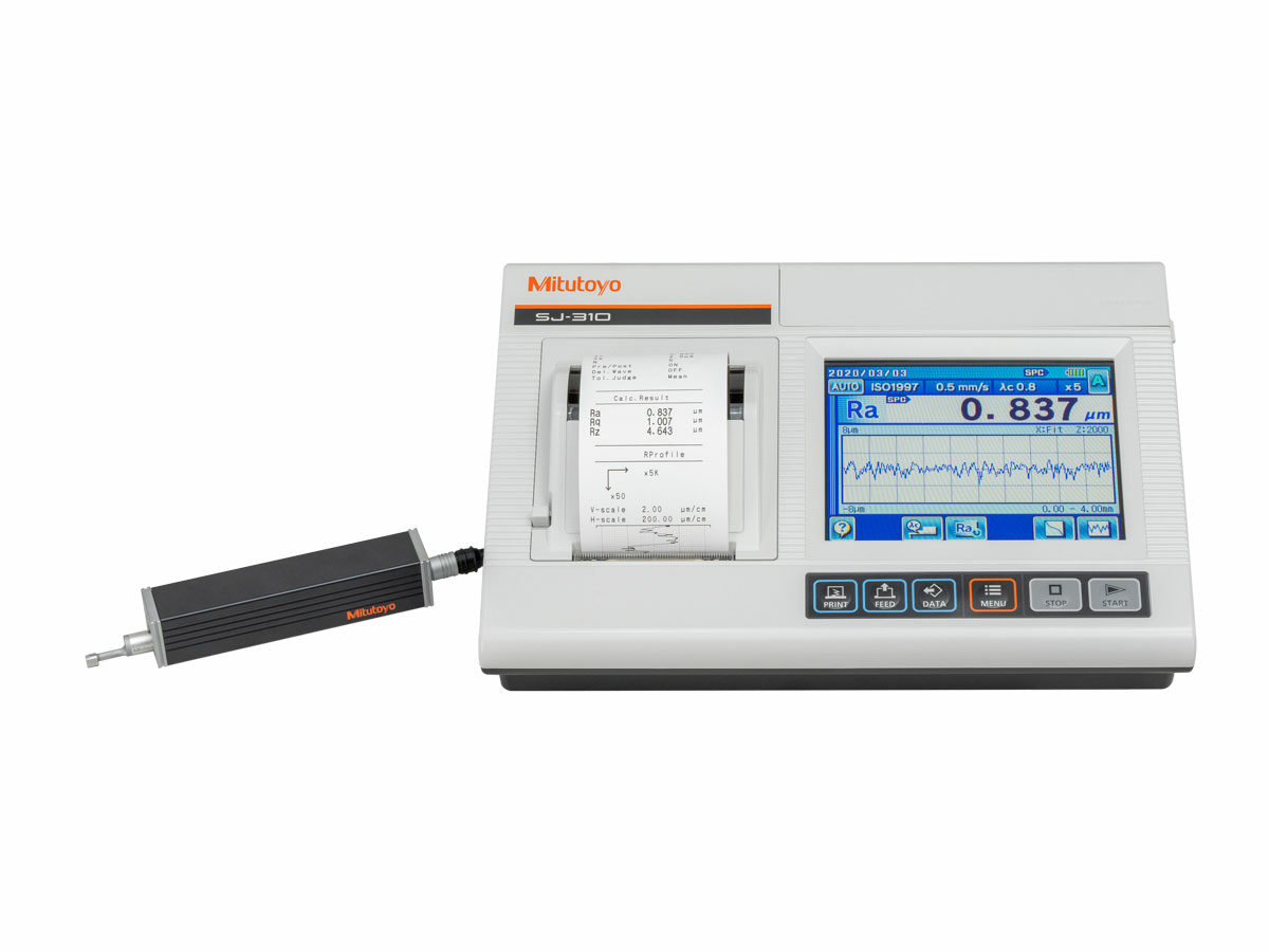

The Surftest SJ-310 surface roughness measuring instrument is a compact, portable and easy-to-use surface roughness measurement instrument equipped with extensive measurement and analysis features.
The Surftest SJ-310 surface roughness measuring instrument provides accurate results in a compact, portable unit. The detector supports a variety of measurement orientations and can make measurements vertically and upside-down. The Surftest SJ-310 includes as built-in thermal printer which provides operators the ability to instantly print measurement results on site.

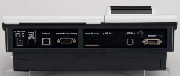

| External I/O: | Digimatic output, Footswitch I/F, Printer output, RS-232C I/F, USB I/F |

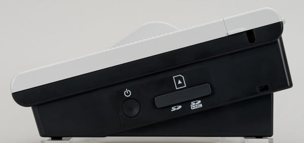

| External Data Storage: | Micro SD card |
