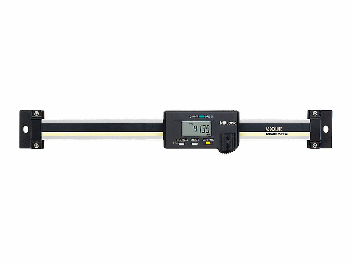

The Mitutoyo ABSOLUTE Digimatic multi-function type linear scale provides accurate linear measurements with digital data output capabilities.
The Mitutoyo SD-E Digimatic scale facilitates mounting on jigs, tools and small machine tools to enable accurate positioning. A built-in ABSOLUTE scale is also included, using the Mitutoyo ABS point, which doesn’t require zero-set when powered on. In addition, overspeed errors have been eliminated which improves reliability.
- ORIGIN key allows setting of an absolute zero point to be used as reference in subsequent measurements
- Horizontal display according to the scale mounting direction
- Long battery life for easier maintenance
- Equipped with an output port to transfer measurement data to implement in control and gaging systems
- EC counters are available as external display units
