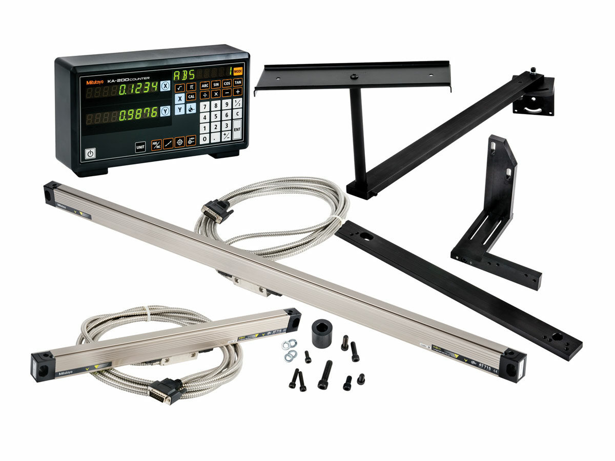

The Mitutoyo KA-200 DRO 2-axis milling system retrofits onto manual milling machines for precision displacement.
The Mitutoyo 2-axis retrofit milling package utilizes a KA-200 digital readout with slim linear scales in several different X- and Y-axis travel lengths on manual milling machines. The KA-200 features ABSOLUTE and incremental modes with nine presets each. Using electromagnetic induction, the included ABSOLUTE AT715 linear scale is not affected by contamination making it ideal for shop floors.
- Includes KA-200 digital counter, AT715 electro-magnetic slim ABSOLUTE linear scales, linear scale brackets and display arm kit
- KA-200 counter can output RS-232C data to a PC, printer or PLC using an optional code out unit (#09AET993)
- The ABSOLUTE scale on the AT715 linear scale eliminates the need for origin resetting for faster, more accurate displacement measurements
- Packages are available in 6 different X-axis travel lengths and 4 Y-axis travel lengths
- IP67 rating (AT715 linear scale) protects linear scale from water and oil contamination
- Comes with 5 year warranty
