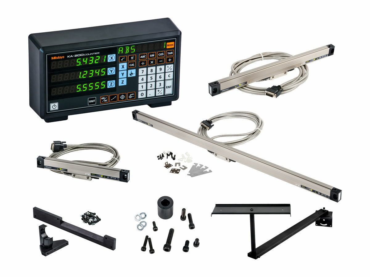

The Mitutoyo KA-200 DRO 3-axis milling system retrofits onto manual milling machines for precision displacement.
The Mitutoyo 3-axis retrofit milling package utilizes a KA-200 digital readout with slim linear scales in many different X-, Y- and Z-axis travel lengths on manual milling machines. The KA-200 features ABSOLUTE and incremental modes with nine presets each. Using electromagnetic induction, the included ABSOLUTE AT715 linear scale is not affected by contamination making it ideal for shop floors.
  • Many different sizes of Quill and Knee 3-axis mill packages are available
  • Includes KA-200 digital counter, AT715 electro-magnetic slim ABSOLUTE linear scales, linear scale brackets and display arm kit
  • KA-200 counter can output RS-232C data to a PC, printer or PLC using an optional code out unit (#09AET993)
  • The ABSOLUTE scale on the AT715 linear scale eliminates the need for origin resetting for faster, more accurate displacement measurements
  • IP67 rating (AT715 linear scale) protects linear scale from water and oil contamination
  • Comes with 5 year warranty
