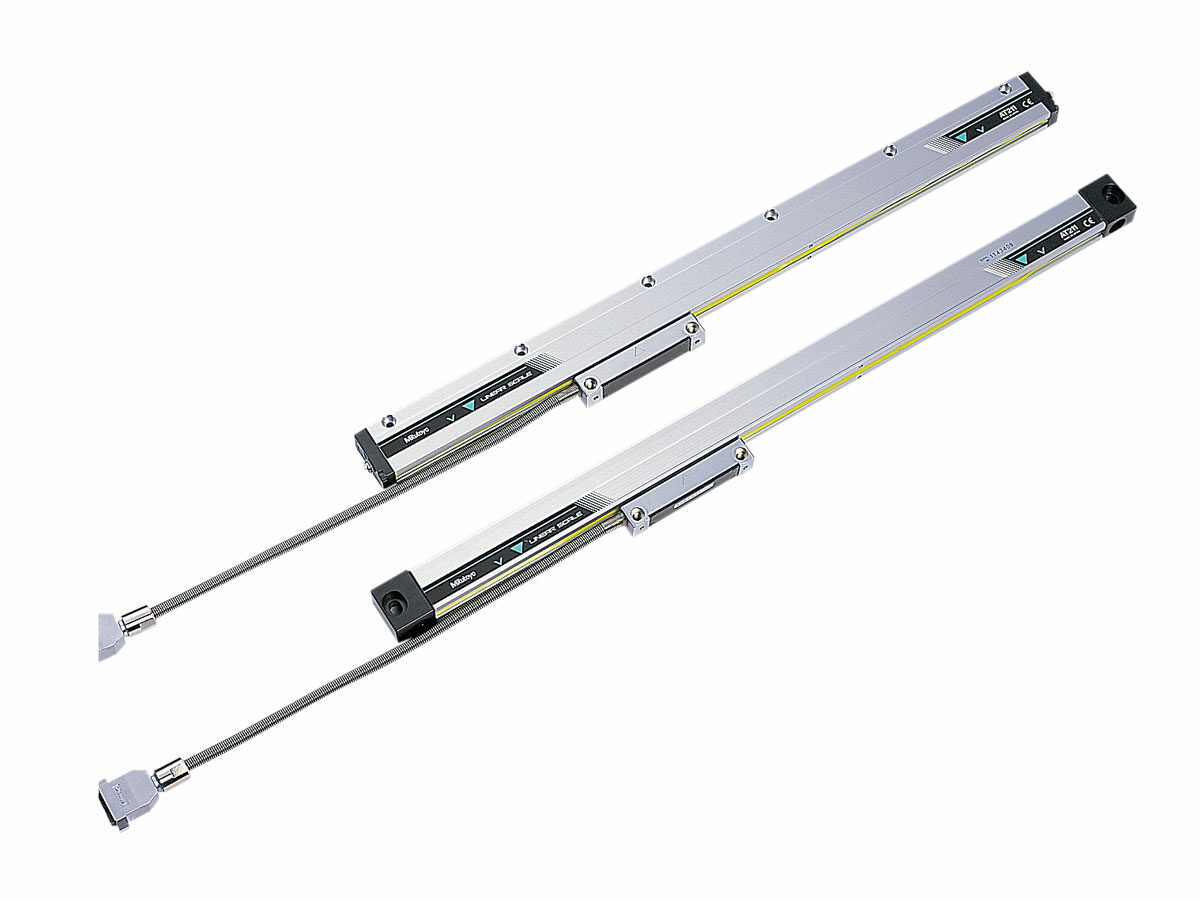

The AT211 is a slim, high-speed sealed linear encoder designed for high-speed motion in many different applications.
The high-resolution, high-accuracy sealed AT211 linear scale is ideal for feedback control in positioning a semiconductor, manufacturing system, CNC machine tool, etc. The two-phase, square wave scale can be directly connected to a control unit.
- Scale alarm display LED allows for easy maintenance
- AT211-A model is a multiple-point installation type designed for improved resistance against vibration and shock
- AT211-B model attaches to a machine at both ends and is compatible with the AT111 slim type in size
- Linear encoder is suitable for control of semiconductor manufacturing systems and CNC machine tools

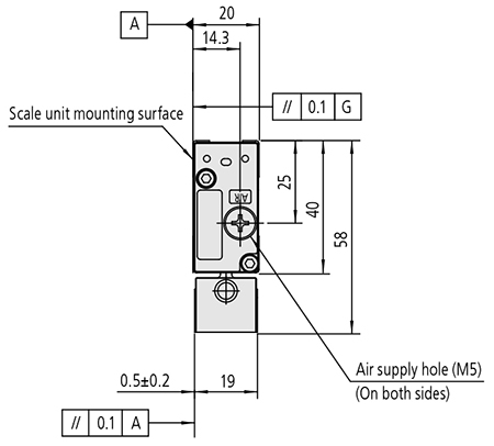

Order No.: | Product Image: | Remarks: | Mounting Method: | Effective Range: | Number of Models: | Accuracy (at 20°C): | Max Response Speed: | Resolution: | Output Signal: | Scale Reference Point: | Protection Level: | Operating Temperature Range: |
AT211 | - | Multiple configurations available, contact sales rep for more information. | Multipoint Mounting | 40 to 60" / 100 to 1500mm | 20 | (3+3L0 /1000)µm | 5.4 to 120m/min (varies depending on the resolution of minimum edge interval) | 0.1/0.2/0.5/1.0/2.5/5.0µm | Two 90 degree phase-shifted square wave signals | 50mm/Center point/Left-edge point/Right-edge point | IP53 | 0 to 45˚C |
