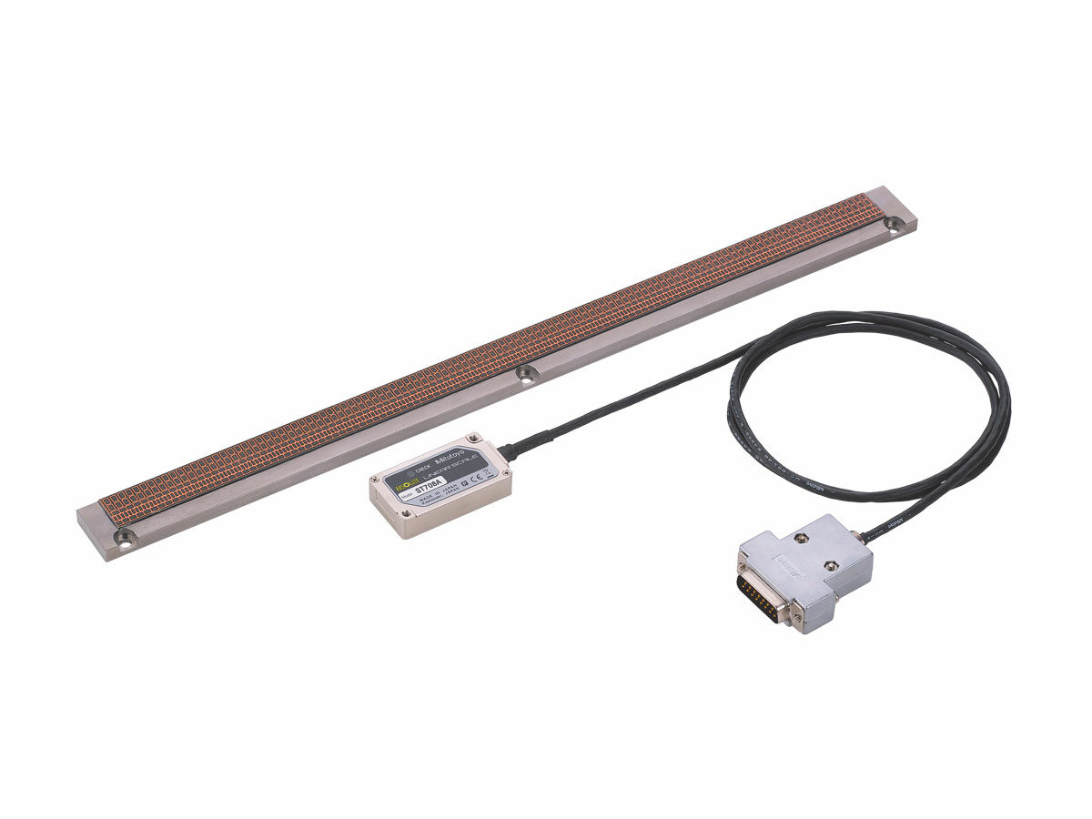

Non-contact detection with the ABS ST700 is optimal for high speed and high acceleration devices such as linear motors.
The ABS ST700 features exposed scales and an electromagnetic induction principle to deliver highly accurate results in harsh environments. The linear scale features improved indication accuracy and outputs data digitally to help eliminate human error.
- The detector head is approximately 1/3 the previous model size for building space-saving systems
- Four directional cable outlets with mounting holes on the top and sides
- Compatible with servo amplifiers from numerous companies (high-speed serial interfaces)
- Signal adjustment at installation is automatically performed with dedicated software
- IP65 rating protects linear scale from water and oil contamination
| Order No.: | Product Image: | Remarks: | Scale Type: | Model: | Resolution: | Detection Method: | Accuracy (at 20°C): | Maximum response speed: | Linear expansion coefficient: | Power supply voltage: | Operating temperature/ humidity range: | Storage temperature/ humidity range: |
| ST700 | - | Multiple configurations available, contact sales rep for more information. | Scale base type / Glass scale type | ABS ST700 | 0.1 (0.5µm to special order)µm | Electromagnetic induction ABS linear encoder | 5+(5L/1000)µm | 5m/s | (12.0±1.5)×10-6/ ºC (When the material of the mounting components is steel or equivalent) / (8±1.0)×10-6/ ºC | 5V±10% (at the detection head) (Ripple + spike noise component should be less than 100mV.) | 0 to 50°C, RH 20 to 80% | –20 to 70°C, RH 20 to 80% |
