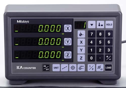

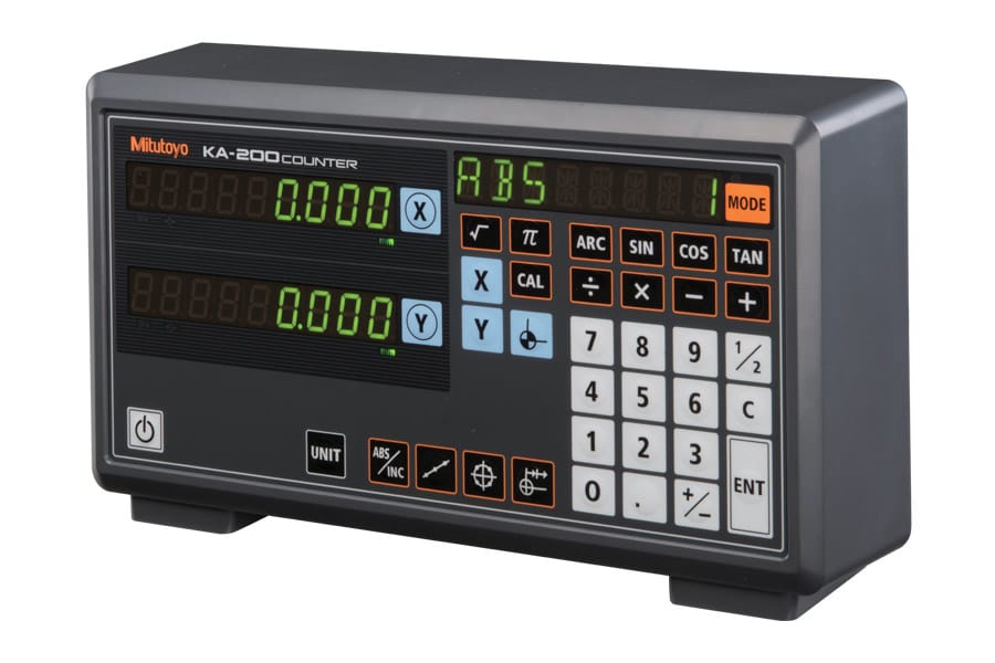

KA-200 Counter
The KA-200 counter is an easy-to-use digital readout for shop milling machines and lathes. Provides great versatility and effortless use with multiple features and an intuitive display.
The multiple features and intuitive display on the KA-200 counter provides great versatility and high performance for both two- and three-axis travel. Each axis has independent resolution readings for diverse precision measurement needs.
  • Absolute and incremental modes are easily toggled with 10 presets each
  • Non-linear and linear error compensation
  • LED display is adjustable for brightness with a high refresh rate for easy readability in any light setting
  • Calculator function allows distance and angle calculations to be simple and error free
  • RS-232C data can output to a PC, printer or PLC using the optional code out unit (09AET993)
  • Data can be sent directly to a spreadsheet using optional USB drive
Type: Standard Type
Resolution: With AT100 Series: 0.05 to 0.0001, With AT715: 0.01 to 0.0005mm / With AT100 Series: .02 to .000005, With AT715: .02 to .000020"
Display: 7-segment, 8-digit + sign + 8-character alphabet LED display, 14.2 mm character height
Output: RS-232C (optional) / USB (optional)
Macro functions: Rectangular drilling and round milling newly added
Optional Accessories: 06ACB391, 06ACB392, 06ACB393, 06ACB913, 06ACF941, 06AET993, 09AAA207 937179T, 09CAB231, 09EAA094, 64AAB336, 64AAB519, 936553, 937328, 965004

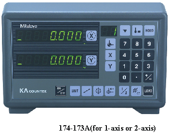

Order No.: Product Image: Model: Scale input ports: Dimensions:

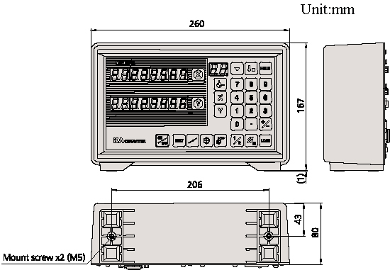

174-183A KA 212 Counter 2 Size (WxDxH) 30x168x70mm
174-185A KA 213 Counter 3 Size (WxDxH) 30x168x71mm
