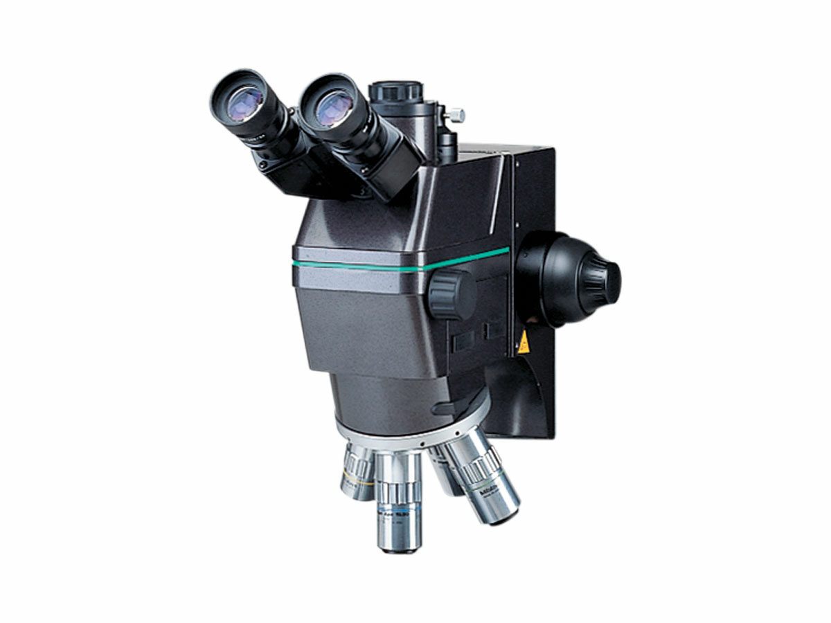

The FS70 series is ideal as a microscope unit for a semiconductor probe station.
The FS70 high-power microscope unit series delivers high magnifications with simultaneous video and binocular viewing of the erect image. A rubber-gripped coarse adjustment knob, enlarged fine-focus adjustment wheel and inward revolver for a longer working distance makes operating the FS70 easier.
•Bright field, differential interference contrast (DIC) and polarized observations are optional with FS70Z and FS70 (FS70L and FS70L4 do not support the DIC method)
• FS70Z – Main Body (Non-Laser) with 1X-2X Zoom Magnification Changer
