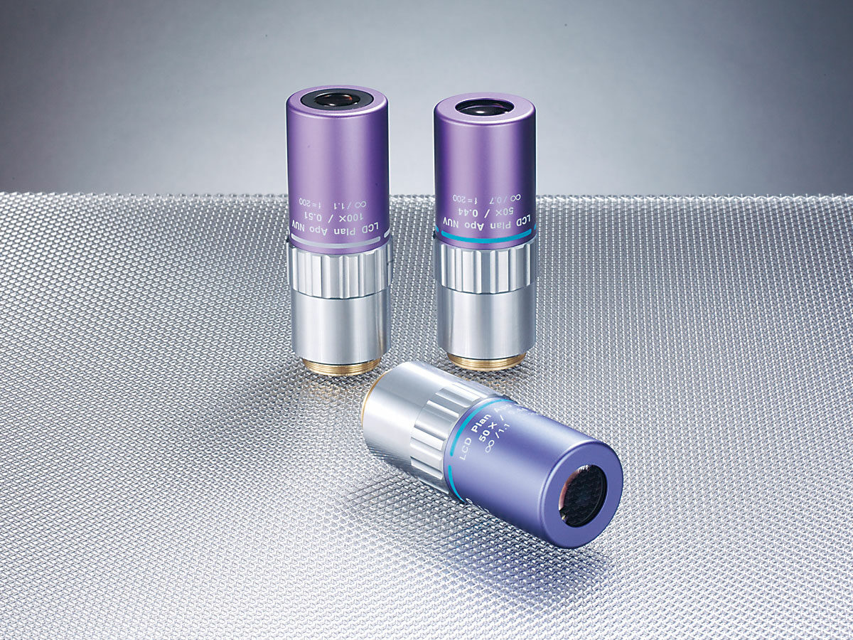

The Mitutoyo LCD Plan Apo Near-ultraviolet objectives are suitable for bright field observation and laser applications through the LCD glass.
LCD Plan Apo NUV High Resolution 0.7mm Glass Thickness Compensated for Brightfield Observation
The Mitutoyo LCD Plan Apo NUV objectives have the world’s longest working distance and an infinity correction optical system for excellent clearance between the lens surface and the workpiece surface in focus. These objectives are compensated and suitable for high-power observation through a sheet of LCD glass of 0.7mm or 1.1mm thick and ideal for repairing lasers.
- Ultra-long working distance makes it possible to observe workpieces that are usually hard to focus because of awkward projection
- Plan apochromatic objective provides a flat, chromatic aberration-free image throughout the field of view, making it suitable for any type of microscope
- Objective design enables high-power observation through a cover glass
- The mounting screw threads of objectives are M26 x 36TPI and conform to JIS B-7141-1988
- Magnifications are available in 20x, 50x and 100x
