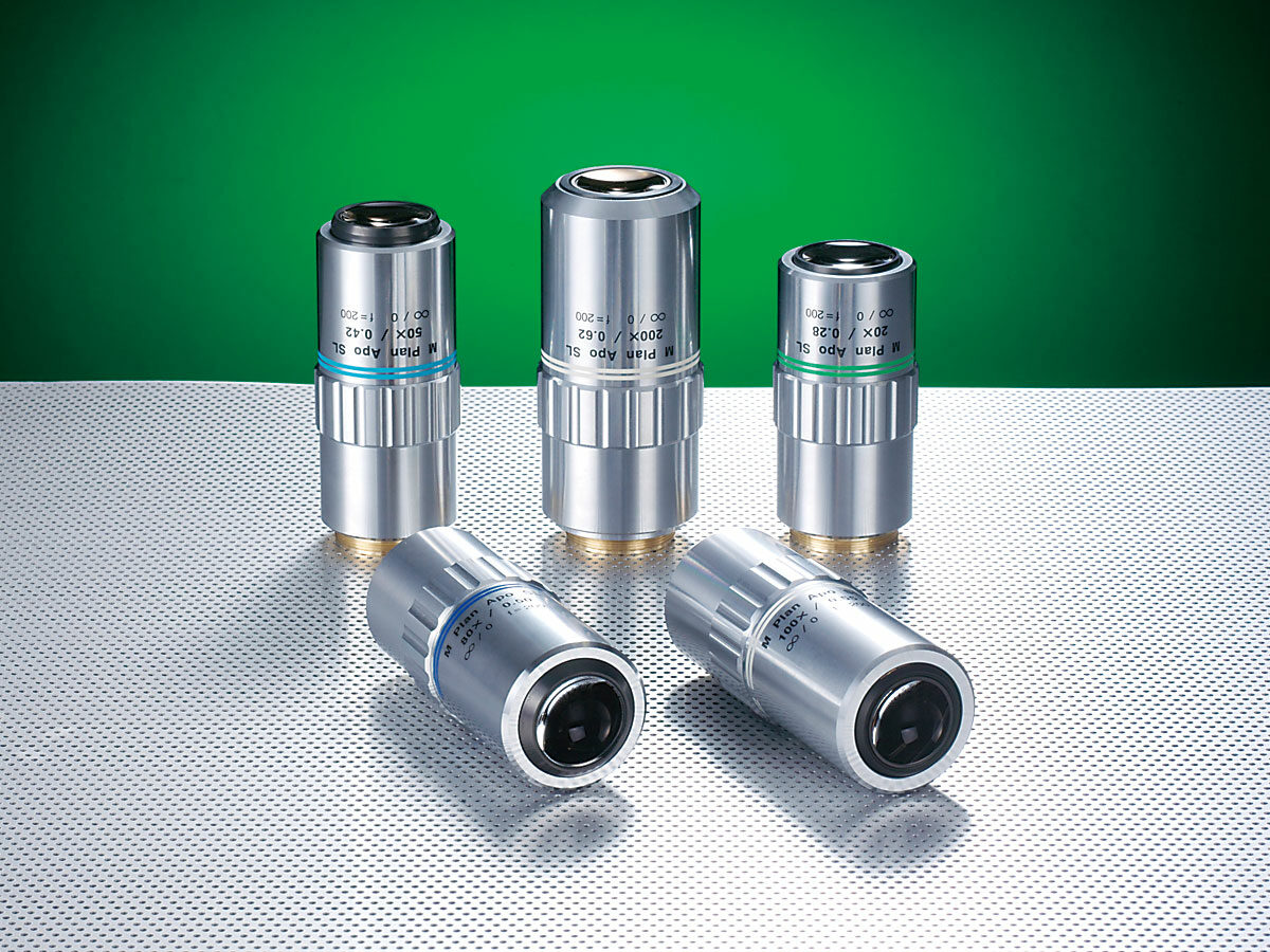

The M Plan Apo objective has a super-long working distance and provides a flat, chromatic aberration-free image throughout the field of view, making it suitable for a wide range of applications.
The Mitutoyo 378 Series Objectives have the world’s longest working distance and are infinity corrected. These objectives provide flexible observation at high magnifications and independent correction of chromatic aberration
- Super-long working distance provides clearance between the lens surface and the workpiece surface in focus for large or awkward workpieces
- The mounting screw threads of objectives are M26 x 36TPI and conform to JIS B-7141-1988
- M Plan Apo bright field objectives have magnification powers of: 20x, 50x and 100x
| Order No.: | Product Image: | Magnification: | N.A.: | W.D.: | f: | R: | Depth of Field: | View Field 1: | View Field 2: | Mass: |
| 378-810-3 | - | 20x | 0.28 | 30.5mm | 10mm | 1µm | 3.5µm | 1.2mm | 0.24 x 0.32mm | 240g |
| 378-811-15 | - | 50x | 0.42 | 20.5mm | 4mm | 0.7µm | 1.6µm | 0.48mm | 0.10 x 0.13mm | 280g |
| 378-813-3 | - | 100x | 0.55 | 13.0mm | 2mm | 0.5µm | 0.9µm | 0.24mm | 0.05 x 0.06mm | 290g |
