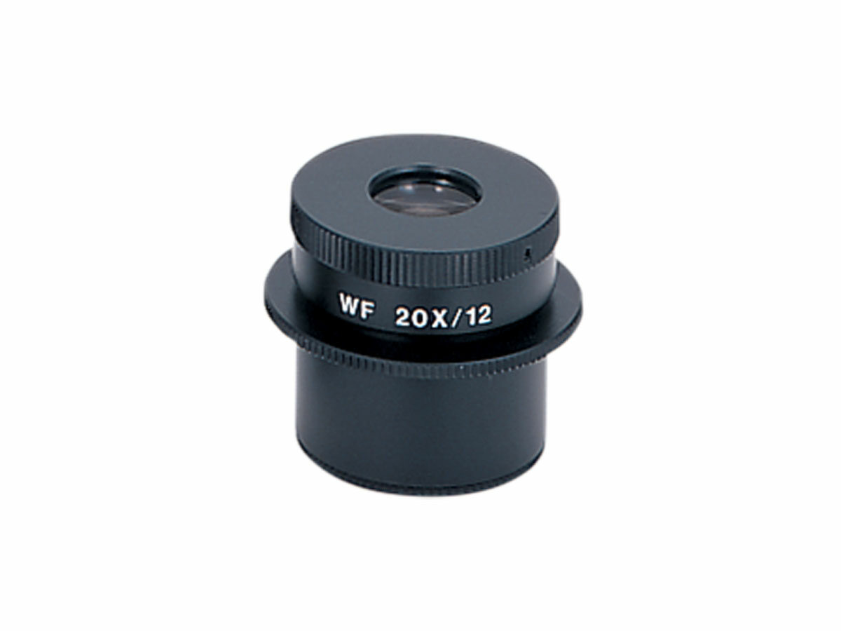

Wide field of view eyepieces are available in 10X and 20X magnification and are compatible to the Mitutoyo MF, MF-U and FS70 microscopes. These eye pieces adopt an outside focus type of optical system.
- Various reticles can be attached to eyepieces according to usage purposes
- Available in 10X and 20X magnifications
- The WF10X/24 has a high eye point and -10D to +5D visibility adjustment
- The WF20X/12 has a normal eye point and -8D to +5D visibility adjustment
Order No.: | Product Image: | Magnification: | Field number: | Mass: |
378-858 | - | 20x | 12 | 55g |
378-866 | - | 10x | 24 | 85g |
