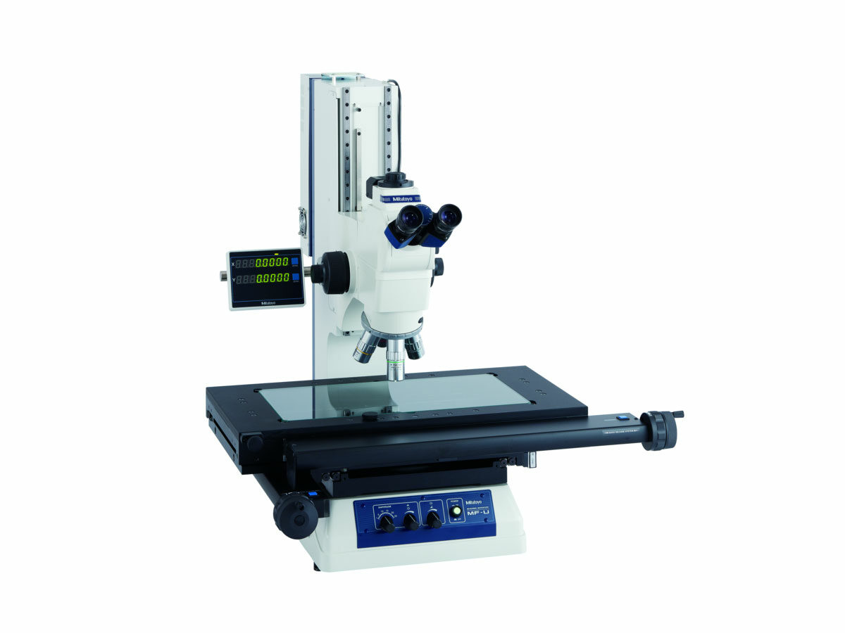

The MF-UC series 176 provides clear observation images with excellent color quality and offers the highest measuring accuracy in its class.
High Powered 2-Axis Brightfield/Darkfield Multi Function Measuring Microscope
The MF-UC series 2-axis measuring microscope gives operators brightfield and darkfield observation and a wide field of view. The microscope’s ultra-long working distance provides the ability to observe larger objects with detail for added flexibility. The MF-U offers microscopy methods such as polarization and differential interference contrast.
• Observation with a clear and flareless erect image and a wide field of view
• Proven high-NA objectives from the FS optical system (long-working distance type)
• Integration of metallurgical and measurement microscope functions provides high-resolution observation and high-accuracy measurement solution
• Illumination unit (reflected/transmitted) selectable from a high-intensity LED or halogen bulb (required)
• Variable aperture diaphragm (reflected/ transmitted) allows for contrast adjustment
• Variety of standardized stages in sizes up to 400 × 200 mm
• Quick-release mechanism useful for moving the stage quickly when measuring workpieces that are large in size or quantity
• High-magnification observation up to 2000X
• Dedicated camera port for seamless integration of Mitutoyo Vision unit or third party c-mount camera
• 4 Position motorized or manual turret is available
