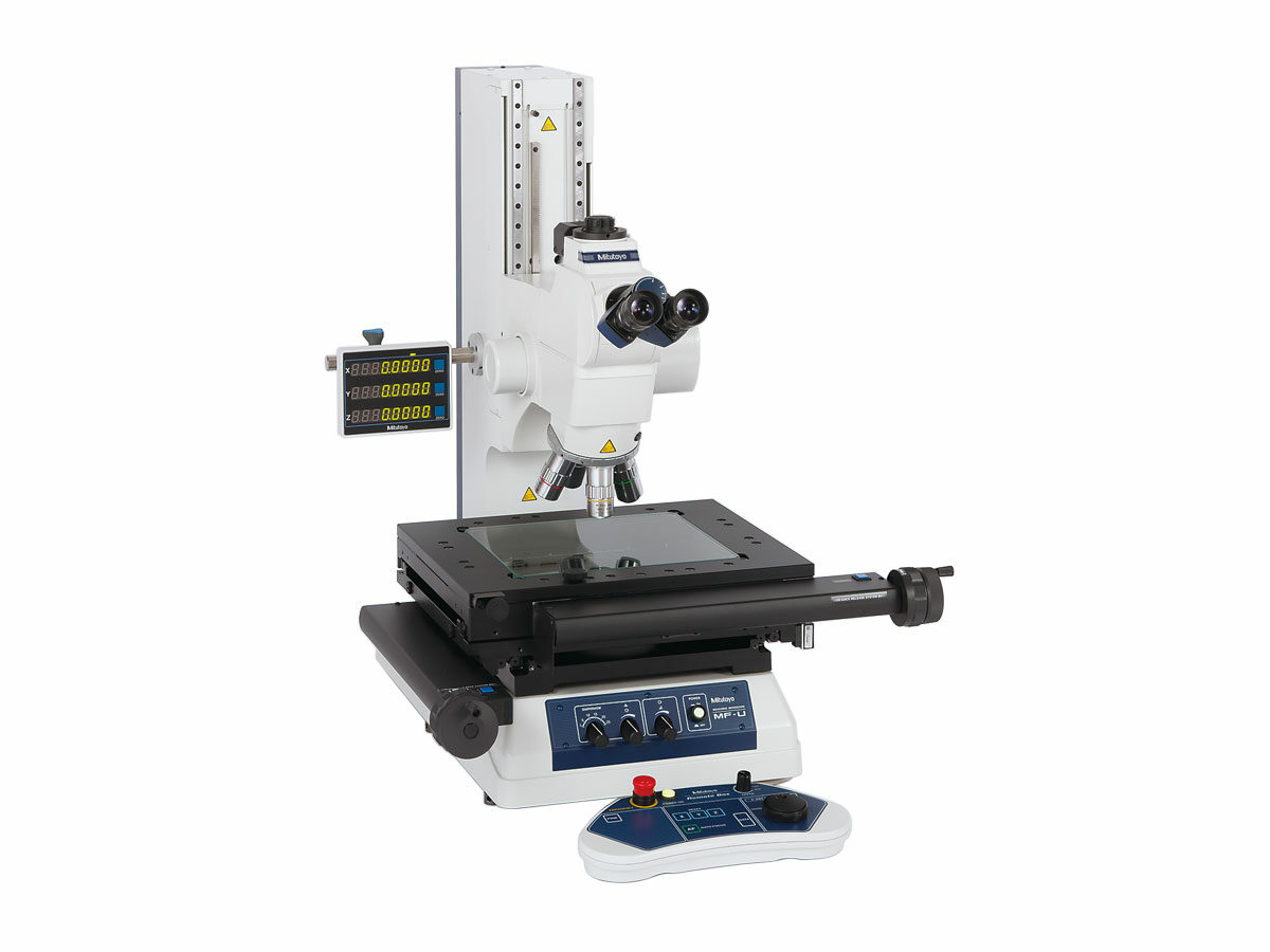

The MF-UK series 3-axis brightfield and darkfield microscope gives operators multi-function observation and a wide field of view. The microscope’s motorized Z-axis can be operated using a remote box for faster, easier measurements and ultra-long working distance objectives provide the ability to observe larger objects with detail for added flexibility.
High Powered 3-Axis Brightfield and Darkfield Multi Function Measuring Microscope with Motorized Z
The MF-UK series 176 provides motorized Z-axis control, clear brightfield and darkfield observations and the highest measuring accuracy in its class.
The MF-UK series 3-axis measuring microscope gives operators brightfield and darkfield observation and a wide field of view. The microscope’s motorized Z-axis can be operated using a remote box for faster, easier measurements and ultra-long working distance objectives provide the ability to observe larger objects with detail for added flexibility. Operator can use auto-focus function when the microscope is used in conjunction with Mitutoyo Vision Unit resulting in a 45% reduction in focus time.
• Integration of metallurgical and measurement microscope functions provides high-resolution observation and high-accuracy measurement solution
• Illumination unit (reflected/transmitted) selectable from a high-intensity LED or halogen bulb (required)
• Variable aperture diaphragm (reflected/ transmitted) allows for contrast adjustment
• Variety of standardized stages in sizes up to 400 × 200 mm
• Quick-release mechanism useful for moving the stage quickly when measuring workpieces that are large in size or quantity
• High-magnification observation up to 2000X
• Dedicated camera port for seamless integration of Mitutoyo Vision unit or third party c-mount camera
• 4 Position motorized or manual turret is available
