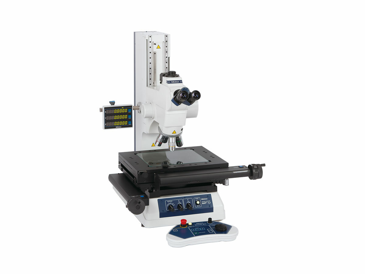

The MF-UJ series 176 provides motorized Z-axis control, clear brightfield observation and the highest measuring accuracy in its class.
High Powered 3-Axis Brightfield Multi Function Measuring Microscope with Motorized Z
The MF-UJ series 3-axis measuring microscope gives operators bright field observation and a wide field of view. The microscope’s motorized Z-axis can be operated using a remote box for faster, easier measurements and ultra-long working distance objectives provide the ability to observe larger objects with detail for added flexibility. Operator can use auto-focus function when the microscope is used in conjunction with Mitutoyo Vision Unit resulting in a 45% reduction in focus time.
• Integration of metallurgical and measurement microscope functions provides high-resolution observation and high-accuracy measurement solution
• Illumination unit (reflected/transmitted) selectable from a high-intensity LED or halogen bulb (required)
• Variable aperture diaphragm (reflected/ transmitted) allows for contrast adjustment
• Variety of standardized stages in sizes up to 400 × 200 mm
• Quick-release mechanism useful for moving the stage quickly when measuring workpieces that are large in size or quantity
• High-magnification observation up to 2000X
• Dedicated camera port for seamless integration of Mitutoyo Vision unit or third party c-mount camera
• 4 or 5 Position motorized or manual turret is available
| Observation Image: | BF ( bright field), Polarization, Differential Interference Contrast (DIC)/Erect Image |
| Eyepiece: | 10X (Standard Accessory ) ( Field number: 24 ) 15X, 20x |
| Objective Lens Brightield: | M Plan Ao, M Plan Apo HR, M Plan Apo SL, G Plan Apo |
| LED Illumination Unit: Control Unit: | 100-240V AC power input connector, Power on/off switch ( main switch ) |
| LED Illumination Unit: Reflected Illumination: | Koehler illumination, non-step light intensity control. , variable aperture diaphragm, white LED light source |
| LED Illumination Unit: Transmitted Illumination: | built-in aperture diaphragm, stepless light intensity control, Telecentric system, White LED Light source, with cooling fan |
| Halogen Illumination Unit: Control Unit: | 100-240V AC Power input connector, Power on/off switch ( main switch) |
| Halogen Illumination Unit: Reflected Illumination: | 12V100W or 12V150W Halogen lamp (selectable), BD/BD Koehler illumination with adjustable aperture diaphragm, External fiber illumination, Stepless brightness adjustment |
| Halogen Illumination Unit: Transmitted Illumination: | Built-in aperture diaphram, Halogen bulb (12V, 50W), Stepless light intensity control, Telecentric system, With cooling fan |
| Range Z-Axis: | 8.7" / 220mm |
| Accuracy: | (2.2 + 0.02L)um L: measuring length (mm) |
| Resolution: | .0001/.00005/.00001" / 1/0.5/0.1mm |
| Order No.: | Product Image: | Model: | Range X-Axis: | Range Y-Axis: |
| 176-894A | - | MF-UJ2017D | 8" / 200mm | 6.7" / 170mm |
| 176-895A | - | MF-UJ3017D | 12" / 300mm | 6.7" / 170mm |
| 176-896A | - | MF-UJ4020D | 16" / 400mm | 8" / 200mm |
