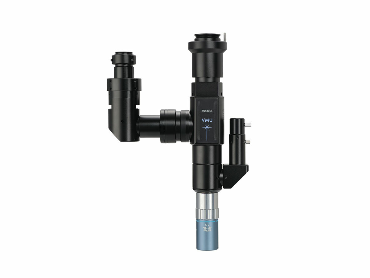

Video Microscope Unit for Laser Applications at 266nm, 355nm, 532nm, and 1064nm
The VMU series is a compact, lightweight microscope unit designed for CCD camera observation system.
This Video Microscope Unit is suitable for observing a wide range of objects such as metal, resin, printed surfaces, fine details, etc. The VMU is compatible with YAG lasers for cutting, trimming, repair of and making of IC wiring, removing and processing thin-film and repair of color filters for defect repairs. The VMU is available for dual-camera (high and low magnification) observation. The VMU’s compact design allows for use in environments where high-power observation is required and space is limited.
• The optical system can accommodate ultra-long working distance objectives and provides correction for the wide range of radiation
• Compatible with infrared optical system for internal observation of IC packages and spectral characteristics analysis using an infrared source and camera
• Available with a laser mount and revolving nosepiece (objective mount)
SERIES 378 Technical Data
Magnification of tube: 1x
Reflected Illumination: Telecentric system with aperture stop. Fiber-optic illuminator is required
Fiber-optic illumination unit: Available as accessory
Order No.: Product Image: Model: Applicable Wavelength: Mass: Vertical CCD Camra Mount: YAG Laser Mount: Fiber-Optic Illumination Unit: M Plan Apo, M Plan Apo SL, G Plan Apo objectives for bright field observation: M Plan Apo NIR, LC Plan Apo NIR, M Plan Apo NUV, and LCD Plan Apo NUV objectives for laser cutting: M Plan UV objectives for laser machining:
378-514 VMU-L4B Visible and ultraviolet 1300g Provided Provided Available as accessory Available as accessory Available as Accessory Available as Accessory
