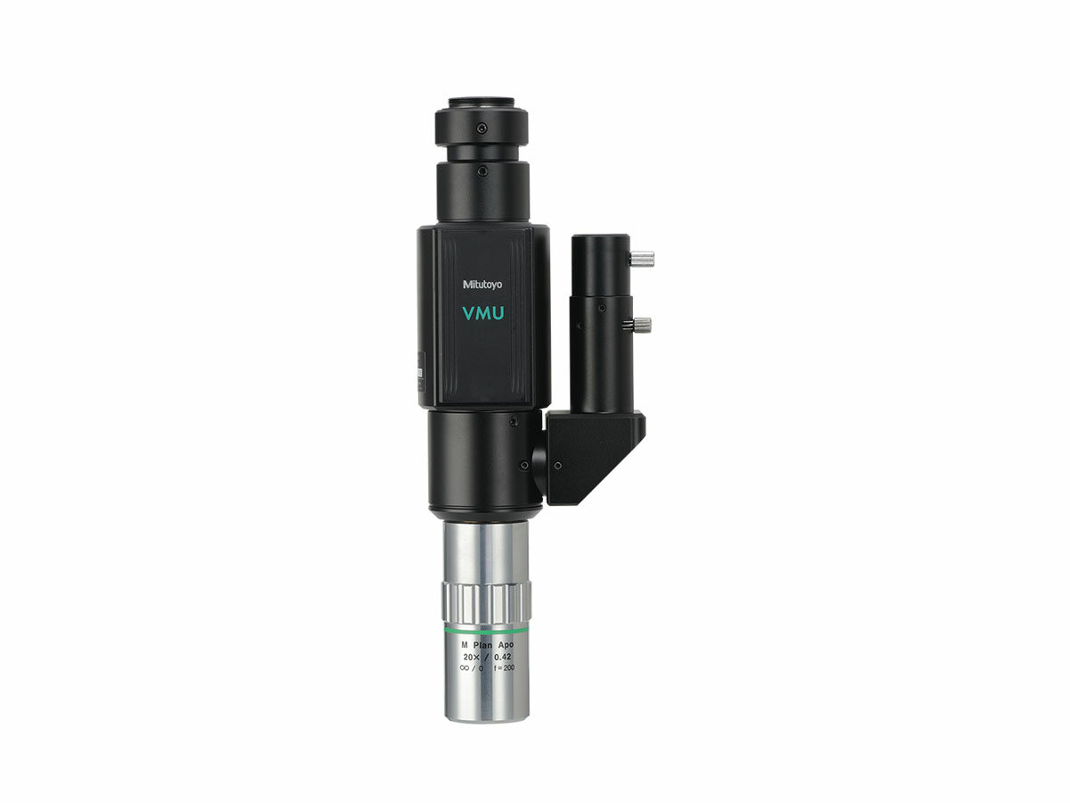

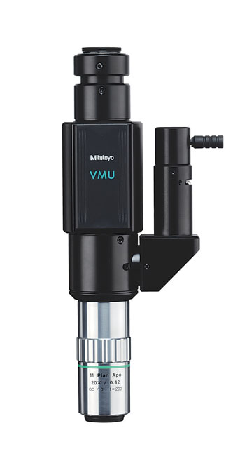

Video Microscope Unit for Visible-NIR Wavelengths with Vertical Camera Mount
The VMU series is a compact, lightweight microscope unit designed for CCD camera observation system.
This Video Microscope Unit is suitable for observing a wide range of objects such as metal, resin, printed surfaces, fine details, etc. The VMU’s compact design allows for use in environments where high-power observation is required and space is limited.
• The optical system can accommodate ultra-long working distance objectives and provides correction for the wide range of wavelengths
SERIES 378 Technical Data
Magnification of tube: 1x
Reflected Illumination: Telecentric system with aperture stop. Fiber-optic illuminator is required
Fiber-optic illumination unit: Available as accessory
Order No.: Product Image: Model: Applicable Wavelength: Light Source: Mass: Vertical CCD Camra Mount: Fiber-Optic Illumination Unit: M Plan Apo, M Plan Apo SL, G Plan Apo objectives for bright field observation:
378-505 VMU-V Near infrared and visible Halogen bulb (21V, 150W) optional 570g Provided Available as accessory Available as accessory
