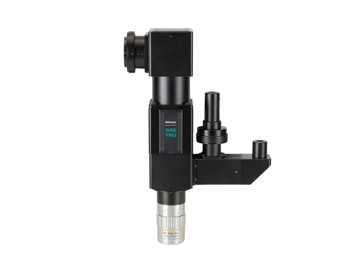

Wide Field Video Microscope Unit, Darkfield Optics with Horizontal Camera Mount
The wide VMU can accommodate a wide-field image sensor, providing seven times greater viewing area than the VMU Series for greatly enhanced inspection efficiency.
This wide view Video Microscope Unit offers an approximately 7 times larger inspection area and increases throughput by allowing for batch measurements. The wide VMU easily installs onto a microscope for CCD camera monitoring suitable for observing a wide range of objects such as metal, resin, printed surfaces, fine details, etc.
• The optical system can accommodate ultra-long working distance objectives and correction for 436nm – 656nm
• BD models can accommodate darkfield optics
SERIES 378 Technical Data
Magnification of tube: 1x
Reflected Illumination: Telecentric system with aperture stop. Fiber-optic illuminator is required
Fiber-optic illumination unit: Available as accessory
Order No.: Product Image: Model: Applicable Wavelength: Mass: Horizontal CCD camera mount: Fiber-Optic Illumination Unit: Bright Darkfield Objectives for Darkfield Illumination:
378-518 - WIDE VMU-BDH Visible 2150g Provided Available as accessory Available as Accessory
