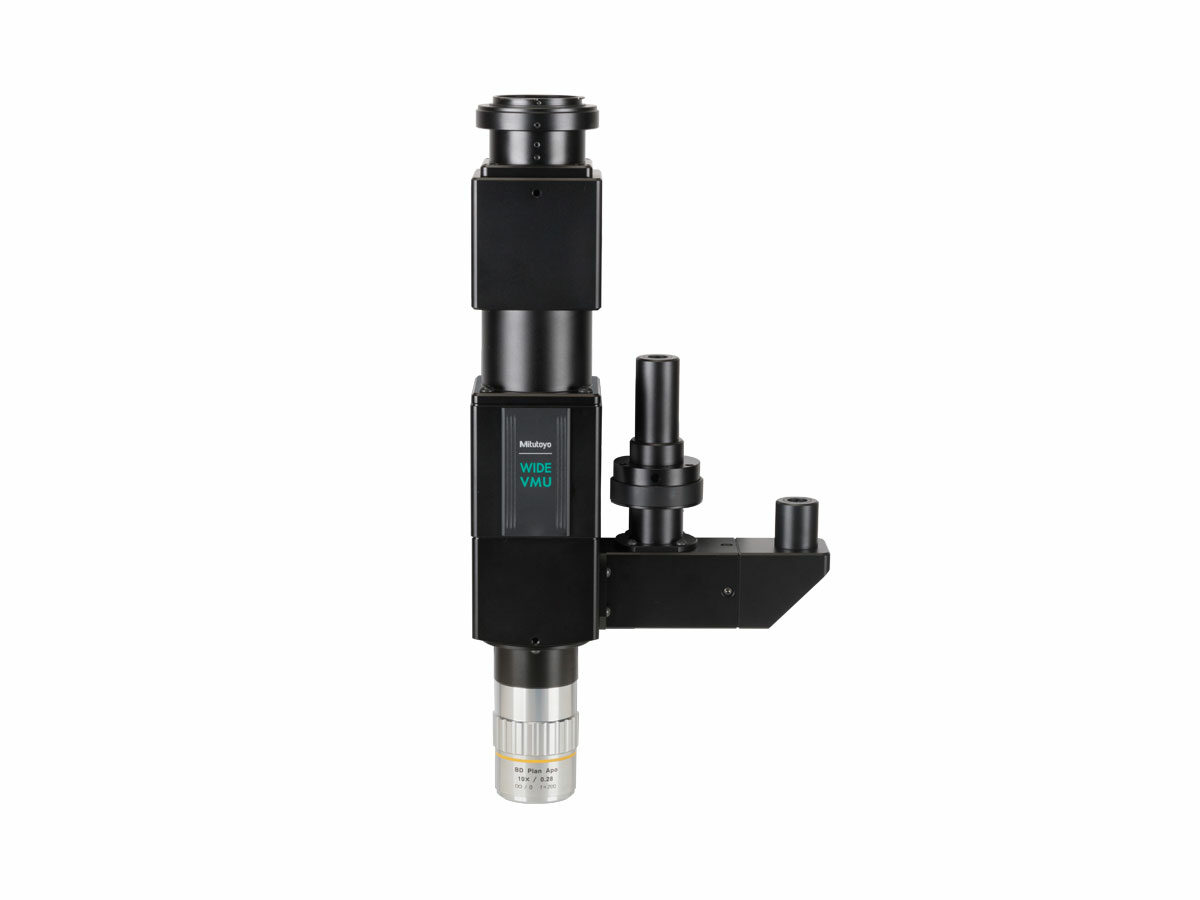

The wide VMU can accommodate a wide-field image sensor, providing seven times greater viewing area than the VMU Series for greatly enhanced inspection efficiency.
Wide Field Video Microscope Unit, Darkfield Optics with Vertical Camera Mount
This wide view Video Microscope Unit offers an approximately 7 times larger inspection area and increases throughput by allowing for batch measurements. The wide VMU easily installs onto a microscope for CCD camera monitoring suitable for observing a wide range of objects such as metal, resin, printed surfaces, fine details, etc.
• The optical system can accommodate ultra-long working distance objectives and correction for 436nm – 656nm
• BD models can accommodate darkfield optics
| Magnification of tube: | 1x |
| Reflected Illumination: | Telecentric system with aperture stop. Fiber-optic illuminator is required |
| Fiber-optic illumination unit: | Available as accessory |
| Order No.: | Product Image: | Model: | Applicable Wavelength: | Mass: | Vertical CCD Camra Mount: | Fiber-Optic Illumination Unit: | Bright Darkfield Objectives for Darkfield Illumination: |
| 378-517 | - | WIDE VMU-BDV | Visible | 2000g | Provided | Available as accessory | Available as Accessory |
