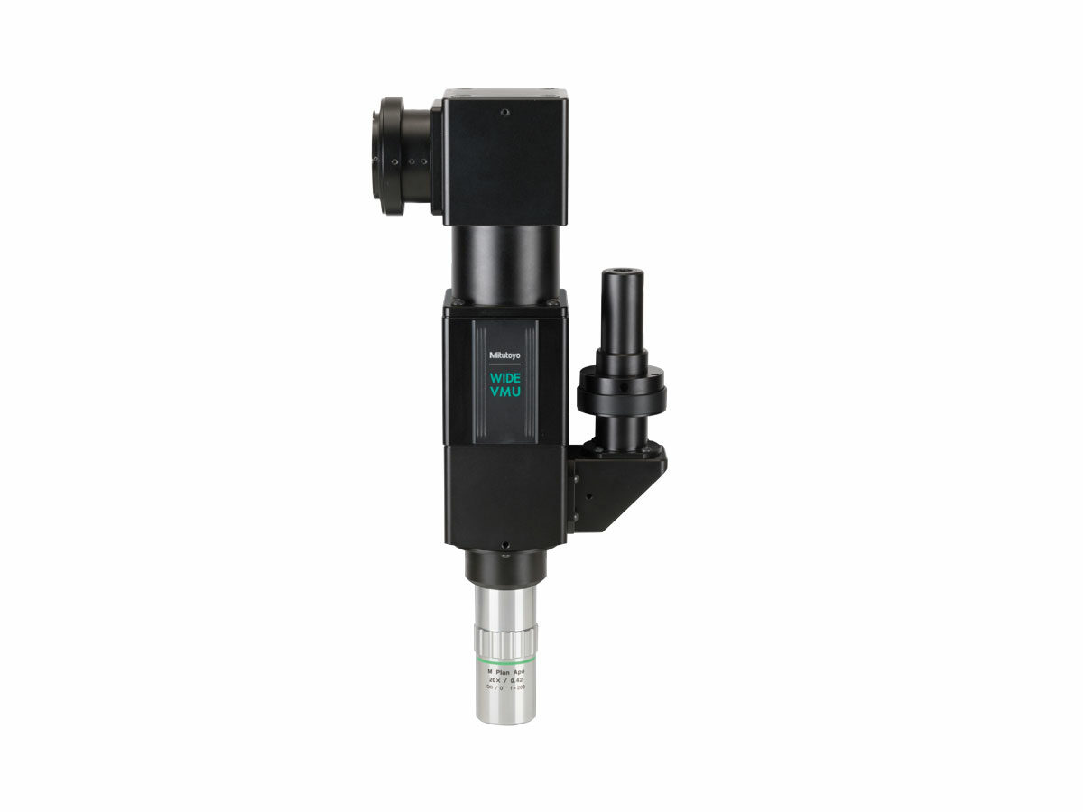

The wide VMU can accommodate a wide-field image sensor, providing seven times greater viewing area than the VMU Series for greatly enhanced inspection efficiency.
This wide view Video Microscope Unit offers an approximately 7 times larger inspection area and increases throughput by allowing for batch measurements. The wide VMU easily installs onto a microscope for CCD camera monitoring suitable for observing a wide range of objects such as metal, resin, printed surfaces, fine details, etc. The rigidity and general performance of the VMU-LB & VMU-L4B have been enhanced compared to previous models.
• The optical system can accommodate ultra-long working distance objectives and correction for 436nm – 656nm
• BD models can accommodate darkfield optics
| Magnification of tube: | 1x |
| Reflected Illumination: | Telecentric system with aperture stop. Fiber-optic illuminator is required |
| Fiber-optic illumination unit: | Available as accessory |
| Order No.: | Product Image: | Model: | Applicable Wavelength: | Mass: | Horizontal CCD camera mount: | Fiber-Optic Illumination Unit: | M Plan Apo, M Plan Apo SL, G Plan Apo objectives for bright field observation: |
| 378-516 | - | WIDE VMU-H | Visible | 1950g | Provided | Available as accessory | Available as accessory |
