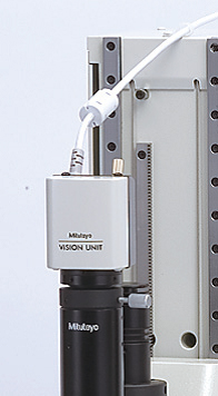

Vision Unit Retrofit for MF Microscopes
The PC-based vision measuring system provides faster, more accurate measurements for the MF and MF-U microscopes.
The automatic edge-detection tools and various macro icons on the Vision Unit System allows measurement on MF and MF-U microscopes in one easy step. To make measurements even simpler and faster, a series of measuring options can be performed using just one screen display. When the vision unit is used in conjunction with a motorized Z-axis, one can perform one-click autofocus resulting in, on average, a 45% reduction in focus time.
• The automatic edge-detection tools and various macro icons allow measurement in one easy step.
• The graphics and measurement navigation functions facilitate operation
• Measurement results are output in CVS format allowing the user generate an inspection table in MS-Excel®
• Allows the tolerance zone measurement of measurement results and various types of statistical processing for each item
• Combined use with the focus pilot provides high-accuracy height measurements (Patent pending)
• The auto-brightness control function reproduces the type and degree of illumination required
• Image data can be input and stored
Order No.: Product Image: Model: On screen Magnification: Image Sensor size: Interface: Measurement Software: Magnification: Accessories:
359-763 Vision Unit 10D 19x-1900x (22" monitor ) 1/2" Cmos USB 2.0 QS Pak VUE 0.5X -
