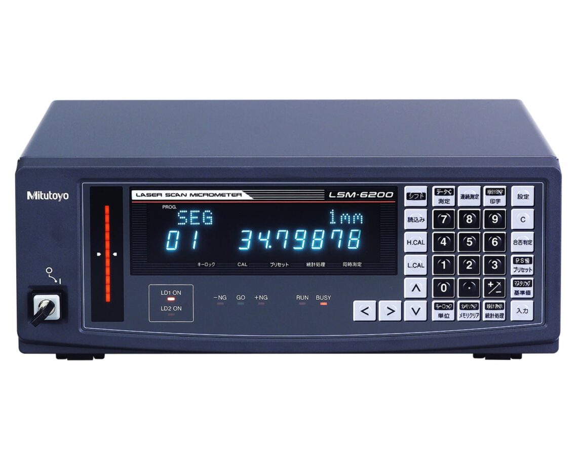

The Mitutoyo LSM-6200 display unit continuously monitors set-up values and provides readouts for two measurement values simultaneously.
The Mitutoyo LSM-6200 series display provides excellent versatility for real-time laser scan micrometer measurement readouts. Its dual-display design allows setup values to be monitored continuously. A simultaneous measurement function allows two measurement value items to be displayed on the sub-display.
