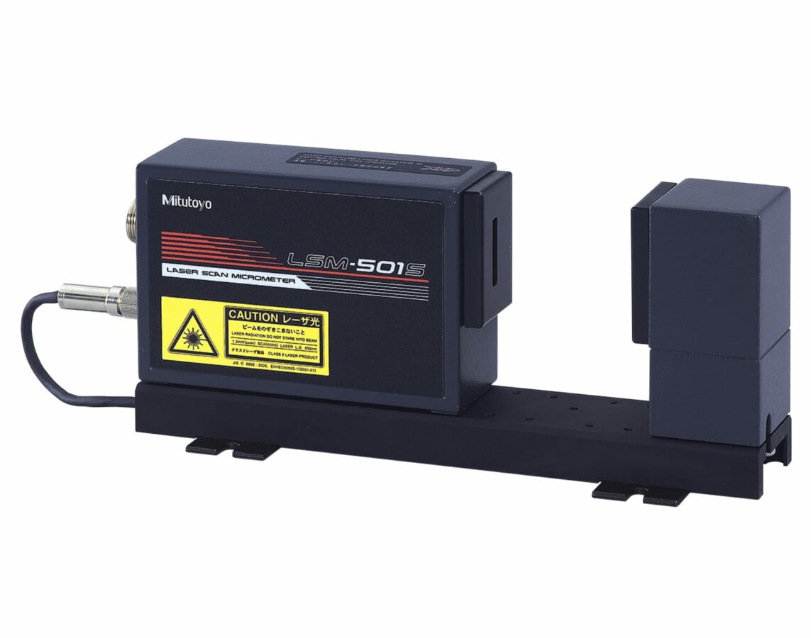

The Mitutoyo LSM-501S Laser Scan Micrometer combines high-rate scanning with highly accurate measurements for a wide range of applications including high speed lines.
The high scanning rate (3200 scans/sec) and non-contact measuring process enables the Mitutoyo LSM-501S laser scan micrometer to provide highly accurate measurements on small, fragile workpieces at high temperatures, even when the target is vibrating or in motion. This capability makes the LSM-501S series ideal for measuring in high-speed production lines.
- Narrow range accuracy of ±(0.3+0.1ΔD)µm for high precision measurement
- Provides ultra-high accuracy of ±0.5μm over the entire measuring range (0.05 to 10mm)
- An IP64-rating resists rough measurement environments allowing it to operate at high temperatures
| Order No.: | Product Image: | Laser Classification: | Applicable Laser Standards: | Laser Wavelength: | Operating Humidity Condition Range: | Operating Temperature Range: | Scanning Rate: | User's manual: | IP Rating: | Laser Scanning Speed: | Max Range: | Max Resolution: | Min Resolution: | Resolution Range: | Measuring Range: | Measuring Area: | Min Range: | Small Range Accuracy: | Narrow Range Accuracy: | Whole Range Accuracy: | Wide Range Accuracy: | Protection Level: | Positional Error: | Repeatability: | Optional Accessories: | Required Accessories: |
| 544-534 | - | Visible (650nm), IEC Class 2/FDA Class II | IEC, FDA | 650 nm | RH35 to 85% (no condensation) | 0 to 40˚C | 3200 scans/second | English | IPIP64 | 113 m/s | 4" /10mm | 0.0005" / 10µm | 0.000001" / 0.01µm | 0.000001-0.0005" / 0.01-10µm | 0.002-0.4" / 0.05-10mm | 2x10 (ø0.05 to ø0.1), 4x10 (ø0.1 to ø10)mm | 0.002" / 0.05mm | ±(0.3+0.1ΔD)µm | ±(0.3+0.1ΔD)µm | ±0.5µm | ±0.5µm | IP64 | ±0.5µm | ±0.04µm | - |
