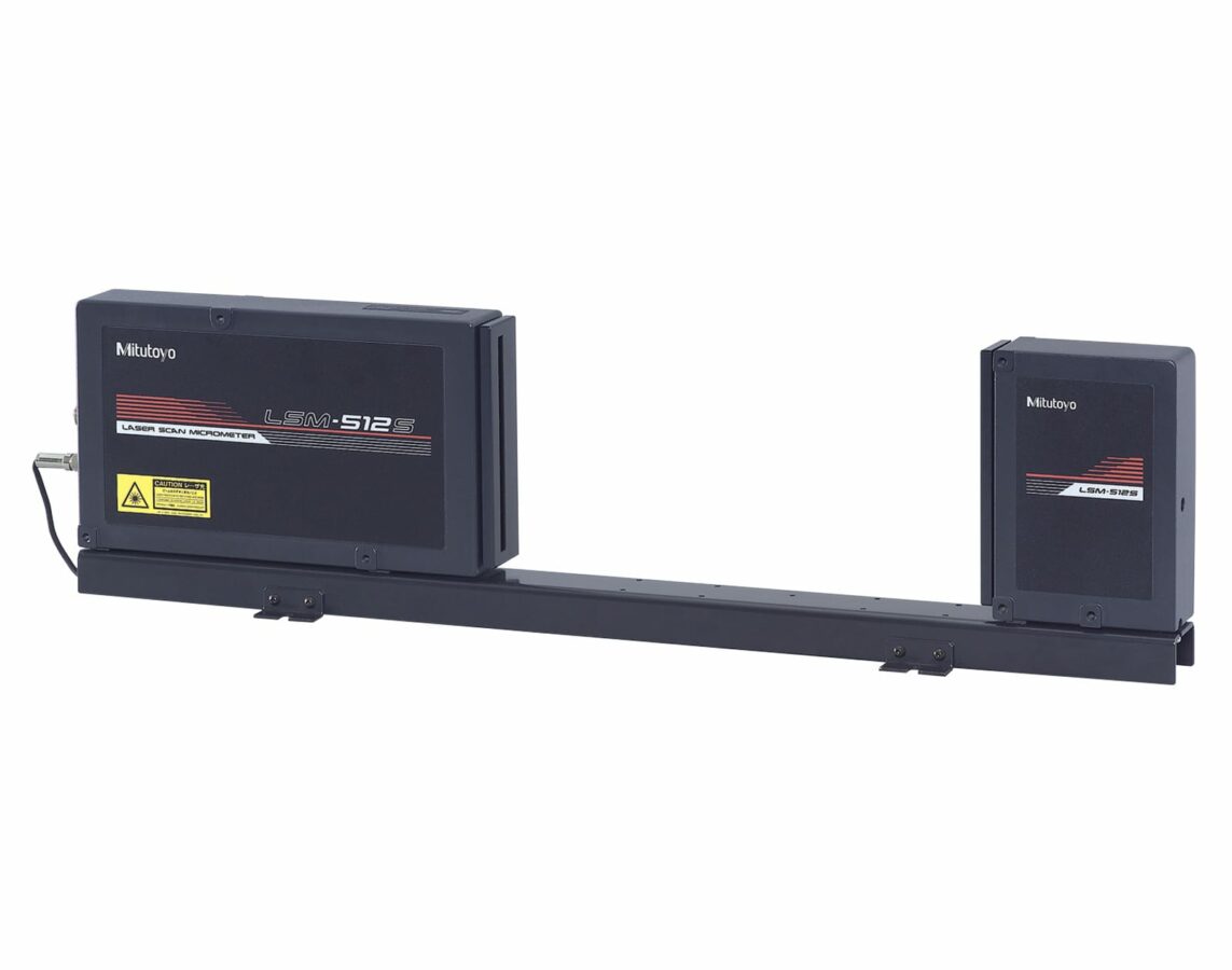

The Mitutoyo LSM-512S series Laser Scan Micrometer combines high-rate scanning with highly accurate measurements for a wide range of applications including high speed lines.
The high scanning rate (3200 scans/sec) and non-contact measuring process enables the Mitutoyo LSM-512S Laser Scan Micrometer to provide highly accurate measurements on small, fragile workpieces at high temperatures, even when the target is vibrating or in motion. This capability makes the LSM-512S series ideal for measuring in high-speed production lines.
- Narrow range accuracy of ±(4.0+0.5ΔD)µm for high precision measurement
- Provides ultra-high accuracy of ±6μm over the entire measuring range (1 – 120mm)
- An IP64-rating resists rough measurement environments allowing it to operate at high temperatures
| Order No.: | Product Image: | Laser Classification: | Applicable Laser Standards: | Laser Wavelength: | Operating Humidity Condition Range: | Operating Temperature Range: | Scanning Rate: | User's manual: | IP Rating: | Laser Scanning Speed: | Max Range: | Max Resolution: | Min Resolution: | Resolution Range: | Measuring Range: | Measuring Area: | Min Range: | Small Range Accuracy: | Narrow Range Accuracy: | Whole Range Accuracy: | Wide Range Accuracy: | Protection Level: | Positional Error: | Repeatability: | Optional Accessories: | Required Accessories: |
| 544-540 | - | Visible (650nm), IEC Class 2/FDA Class II | IEC, FDA | 650 nm | RH35 to 85% (no condensation) | 0 to 40˚C | 3200 scans/second | English | IPIP64 | 904 m/s | 4.72" /120mm | 0.005" / 100µm | 0.000005" / 0.1µm | 0.000005-0.005" / 0.1-100µm | 0.04-4.72" / 1-20mm | 30x120 (ø1 to ø120)mm | 0.04" / 1mm | ±(4+0.5ΔD)µm | ±(4+0.5ΔD)µm | ±6µm | ±6µm | IP64 | ±8µm | ±0.85µm | - |
