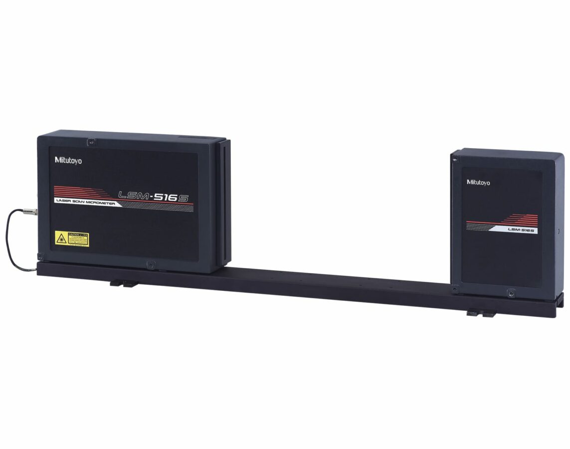

The Mitutoyo LSM-516S series Laser Scan Micrometer combines high-rate scanning with highly accurate measurements for a wide range of applications including high-speed production lines.
The high scanning rate (3200 scans/sec) and non-contact measuring process enables the Mitutoyo LSM-516S Laser Scan Micrometer to provide highly accurate measurements on small, fragile workpieces at high temperatures, even when the target is vibrating or in motion. This capability makes the LSM-516S series ideal for measuring in high-speed production lines.
- Narrow range accuracy of ±(4.0+0.2ΔD)µm for high precision measurement
- Provides ultra-high accuracy of ±7μm over the entire measuring range (1 – 160mm)
- An IP64-rating resists rough measurement environments allowing it to operate at high temperatures
Order No.: | Product Image: | Laser Classification: | Applicable Laser Standards: | Laser Wavelength: | Operating Humidity Condition Range: | Operating Temperature Range: | Scanning Rate: | User's manual: | IP Rating: | Laser Scanning Speed: | Max Range: | Min Resolution: | Max Resolution: | Resolution Range: | Measuring Range: | Measuring Area: | Min Range: | Small Range Accuracy: | Narrow Range Accuracy: | Whole Range Accuracy: | Wide Range Accuracy: | Protection Level: | Positional Error: | Repeatability: | Optional Accessories: | Required Accessories: |
544-542 | - | Visible (650nm), IEC Class 2/FDA Class II | IEC, FDA | 650 nm | RH35 to 85% (no condensation) | 0 to 40˚C | 3200 scans/second | English | IPIP64 | 1206 m/s | 6.3" /160mm | 0.000005" / 0.1µm | 0.005" / 100µm | 0.000005-0.005" / 0.1-100µm | 0.04-6.30" / 1-160mm | 40x160 (ø1 to ø160)mm | 0.04" / 1mm | ±(4+2ΔD)µm | ±(4+2ΔD)µm | ±7µm | ±7µm | IP64 | ±8µm | ±1.4µm | - |
