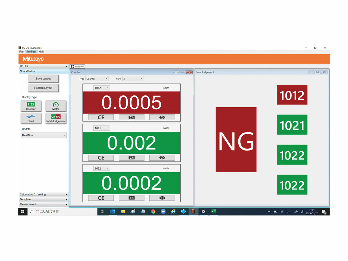

The Mitutoyo EJ Counter software has all the popular features of SENSORPAK but also has the ability to set up counters. The software is a free download and can set up units, resolution, button lockout, tolerances and even I/O settings on a variety of Mitutoyo counters.
- Software is true plug-and-play and automatically starts after free download
- Most live reading features are about the same as SENSORPAK
- CSV output for sending data into Excel is still available
Order No.: | Applicable gage: | Display Types: | Function: | Gage Capacity: | PC Requirement: |
EJ Software | EJ Counter w/Interface | Counter, Bar Graph, Meter, Chart | Display type selection, Tolerance Judgement, Go/No-go (3 or 5 step), Trigger function, Timer, CSV file output, Calculation items: sum, difference, total, average, max, min, range, multiplier, Max 18 gage input | 18 | OS: Windows 10 Pro 32-bit or 64-bit version, Display resolution: 1600 × 1200 or better, RAM: 1024 MB or more, Communication protocol: USB 2.0 (Full speed), USB connector: Type C, Standard Windows drivers are used for the, USB device driver, USB cable is optional |
