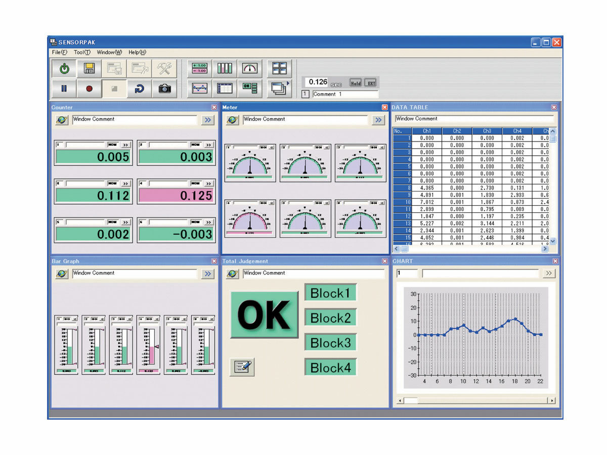

The SensorPak software facilitates loading measurement data onto a personal computer from a linear gage counter with RS-232C output (EH, EV), with USB output (EH), or from a Litematic display (VL).
Sensorpak Software
SensorPak enables measurement data to be loaded onto a personal computer from a linear gage with RS-232C output, USB output or from a Litematic display unit. The software allows for arithmetical and maximum width calculations to be performed using the measurement data.
- A maximum of 60 channels of measurement data can be processed
- Real-time graphical display by means of bar graph or meter is provided
- Software supports exporting measurement data into Microsoft Excel format
- Any gage that can be connected to an EH or EV counter can be used in SensorPak
