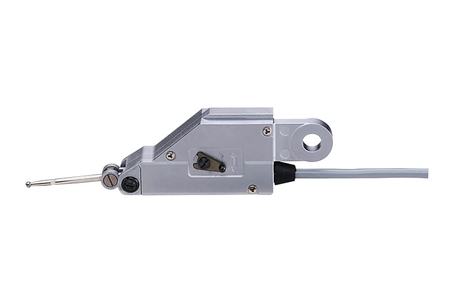

The Mitutoyo lever head Mu-Checker probes are available in two types: pivoted stylus and and parallel translation types.
The Mitutoyo lever head Mu-checker probes offer interchangeable styli with a half bridge connection.
- Available in two types of stylus support: Pivot bearing and parallel-leaf spring
- Measuring range ±0.5 mm
- A 2M cable is provided
- Optional mounting brackets available
Connecting Cable: | 2m |
Connection: | MAS-5100 (DIN5P) |
Linearity: | 0.3 ± |
Main Body Assembly: | Lever Head |
Max Resolution: | 0.000005" / 0.1µm |
Min Resolution: | 0.001" / 50µm |
Measuring Range: | ± 0.5 mm |
Position Detection Method: | Half-bridge LVDT |
Output: | Half-bridge |
Order No.: | Product Image: | Bearing Type: | Measuring Force: | Resolution: | Stroke: | Remarks: | Optional Accessories: |
519-326 | - | Parallel-leaf spring | 0.15N | - | ±0.6mm | Parallel translation, cosine error-free | - |
519-327 | - | Pivot bearing | 0.15N | - | ±0.65mm | - | - |
519-521 | - | Pivot bearing | 0.2N | 0.000005" | ±0.6mm | - | - |
519-522 | - | Pivot bearing | 0.02N | 0.000005" | ±0.6mm | Low measuring force | - |
