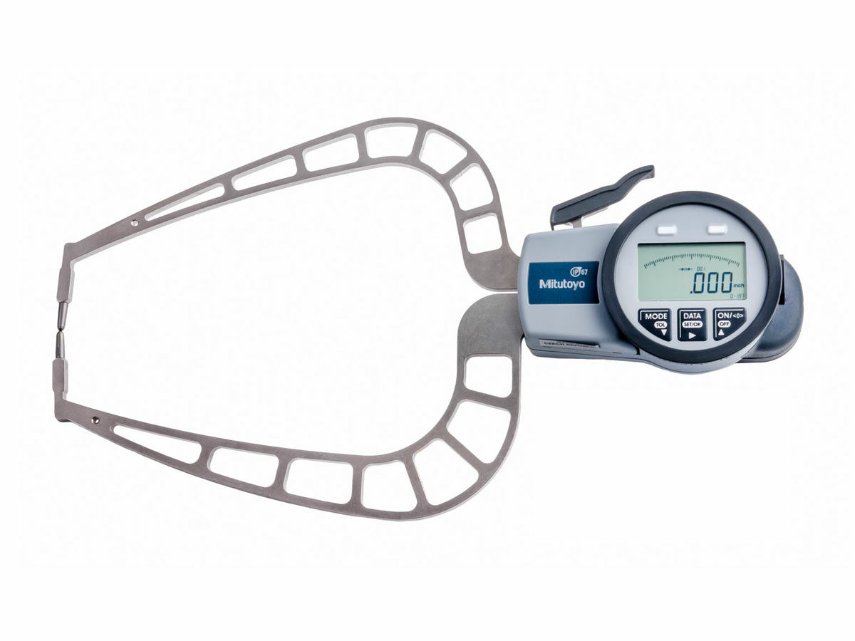

The Mitutoyo ABSOLUTE digital external tube thickness gage provides accurate outer dimension measurements of tube diameters and thickness, groove thickness and other other hard-to-measure outside dimensions. Measurements are shown on an easy-to-read LCD display.
External Digimatic Tube Thickness Caliper Gage
The highly versatile Mitutoyo ABSOLUTE Digimatic external tube thickness gage is designed to accurately measure tube outer diameters. This tube thickness gage is ideal for measuring other outside dimensions such as hole diameters, groove depths and thicknesses, and many other flat or round outside dimensions. The spring-loaded lever makes the thickness gage simple to use in tight spaces, and the operational buttons provide quick feature and measurement access.
- Available in Metric/Inch models only
- SPC output capabilities available
- Available with disc or ball measuring contacts
- Signal can be output to external device; waterproof data output connector protects against dust, water and oil ingress
- ABSOLUTE (ABS) linear scale eliminates the need for setting the origin point every time the micrometer is powered on
- Origin reset is not required even when data is re-displayed after disappearance due to insufficient illumination during use
- SPC output function allows for quick and easy data management in real time
- Functions include: Zero-setting, preset, data hold, data output, Max/Min value holding, auto power off, and inch/mm conversion
- Alarm: Low voltage, scale surface contamination and over-flow error
- Unlimited response speed eliminates over-speed errors
- Measuring force: 0.9-1.8N
- IP67 protection eliminates dust ingress, protects against temporary water submersion; permits use in environments exposed to cutting oil, dust, etc.
- Inspection certificate included
