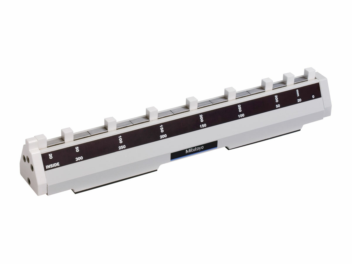

The Mitutoyo CERA Caliper Checker efficiently and accurately inspects Digimatic, dial and Vernier calipers.
View Dimensions
The CERA Caliper Checker is a reference gage that supports the calibration of all types of calipers for accuracy. Comprised of permanently wrung, high-grade CERA gage blocks in a protective casting, the Caliper Checker confirms reference measurements in 50mm increments. The checker also verifies and adjusts a caliper’s base zero position. The CERA Caliper Checker stands perpendicular to a surface for height gage inspection.
  • Available in 0-300mm, 0-600mm or 0-12”
  • Made of zirconia-based ceramic CERA measuring blocks that are dimensionally stable and corrosion resistant

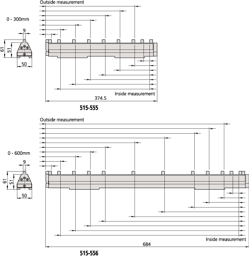

Order No.: Product Image: Units: Range: Block pitch accuracy (20-300): Block pitch accuracy (250-600): Block pitch accuracy: Parallelism of Blocks (20-300): Parallelism of Blocks (350-600): Parallelism of Blocks: Mass: Remarks: Optional Accessories:
515-555 - Metric 0-300mm ±5µm - - 2µm - - 4.0kg Outside measurement: 20, 50, 100, 150, 200, 250, 300mm Inside measurement: 20, 300mm -
515-556-2 - Metric 0-600mm ±5µm ±7µm - 2µm 4µm - 8.5kg Outside measurement: 20, 50, 100, 150, 200, 250, 300, 350, 400, 450, 500, 550, 600mm Inside measurement: 20, 600mm -
515-565 Inch 0-12" - - ±0.0002" - - 0.00008" 4.0kg Outside measurement: 1", 2", 4", 6", 8", 10", 12" Inside measurement: 1", 12" -
