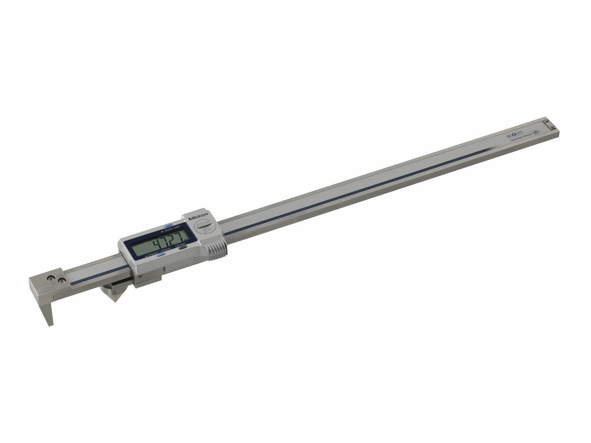

The Mitutoyo ABSOLUTE back-jaw centerline caliper is specially designed to measure the distance between two centers or the distance from an edge to center and is IP67 rated.
Series 573
Absolute Back-Jaw Centerline Caliper
The Mitutoyo ABSOLUTE back-jaw centerline caliper delivers accurate, repeatable center-to-center and edge-to-center distance measurements with unrestricted speed. The back-jaw centerline caliper has jaws on the back of the slider so measurements can easily be read upside down. An offset value setting function allows direct readings of pitch measurements. Measurements are displayed on an easy-to-read LCD readout.
- Available in Metric models only
- ABSOLUTE (ABS) linear scale eliminates the need for setting the origin point every time the micrometer is powered on
- Origin reset is not required even when data is re-displayed after disappearance due to insufficient illumination during use
- Stainless steel construction protects caliper components and ensures accurate performance for longer
- SPC output function allows for fast and easy data management in real time
- Functions include Zero-setting, Origin Set, Power On/Off, and Data output
- Alarm: Low voltage, Counting value composition error
- Unnecessary to wipe or clean the scale
- Supplied in a fitted wooden case
SERIES 573 Technical Data
| Technology: | Digimatic |
| Length Standard: | ABSOLUTE electostatic capacitance type linear encoder |
| IP Rating: | IP67 |
| Display: | LCD |
| SPC Output: | Yes |
| Units: | Metric |
| Resolution: | 0.01mm |
| Optional Accessories: | 05CZA624, 05CZA625, 959143 |
