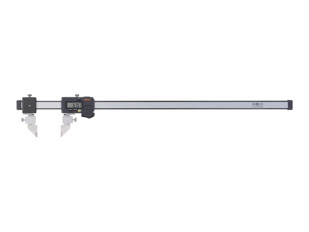

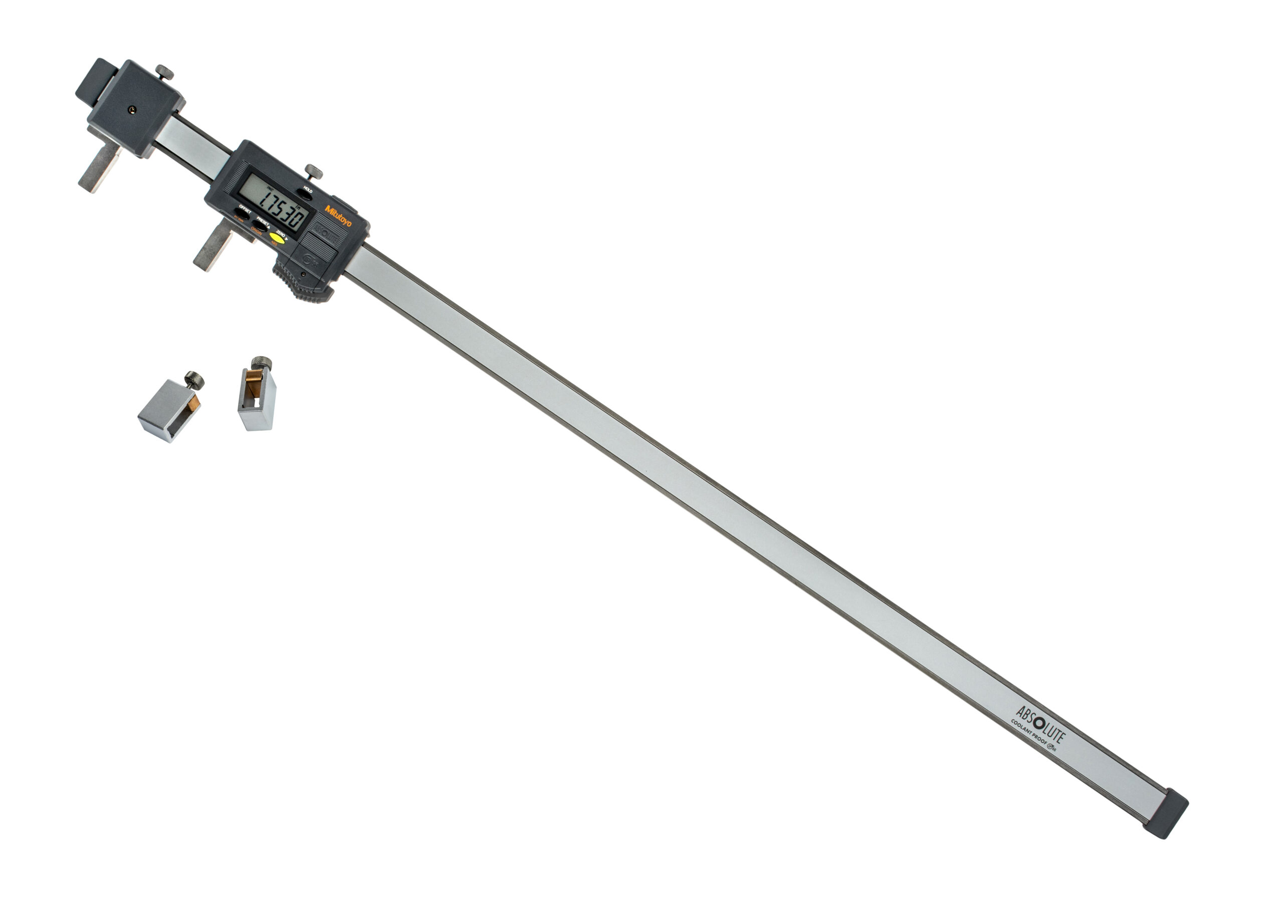

The Mitutoyo ABSOLUTE Digimatic carbon fiber caliper with interchangeable jaw attachments is lightweight and highly durable, providing accurate inside and outside dimension measurements for a variety of applications.
ABSOLUTE Coolant-Proof Carbon Fiber Caliper with Interchangeable Jaws

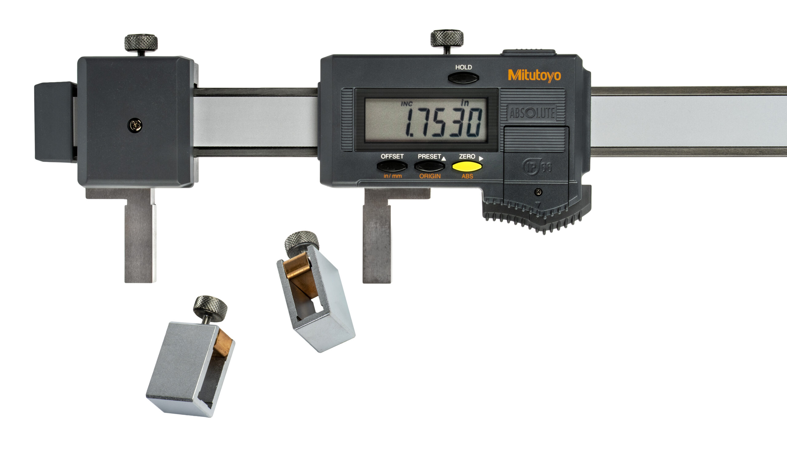

The Mitutoyo ABSOLUTE digital carbon fiber caliper uses reinforced carbon fiber plastics (CFRP) in the beam and jaws to reduce weight and increase the durability of the caliper. A unique clamping mechanism makes changing the optional interchangeable jaws quick and easy. Measurements are displayed on a digital LCD readout with SPC output for easier, automatic recording.
- Available in Inch/Metric models
- Functions include Origin Set, Zero Setting, Presetting, Offsetting, Automatic On/Off, Data Hold, Data Output and inch/mm conversion (on inch/metric models only)
- Constructed of lightweight, durable carbon fiber composites
- IP66 protection eliminates dust ingress, protects against high pressure jets; permits use in environments exposed to cutting oil, dust, etc.

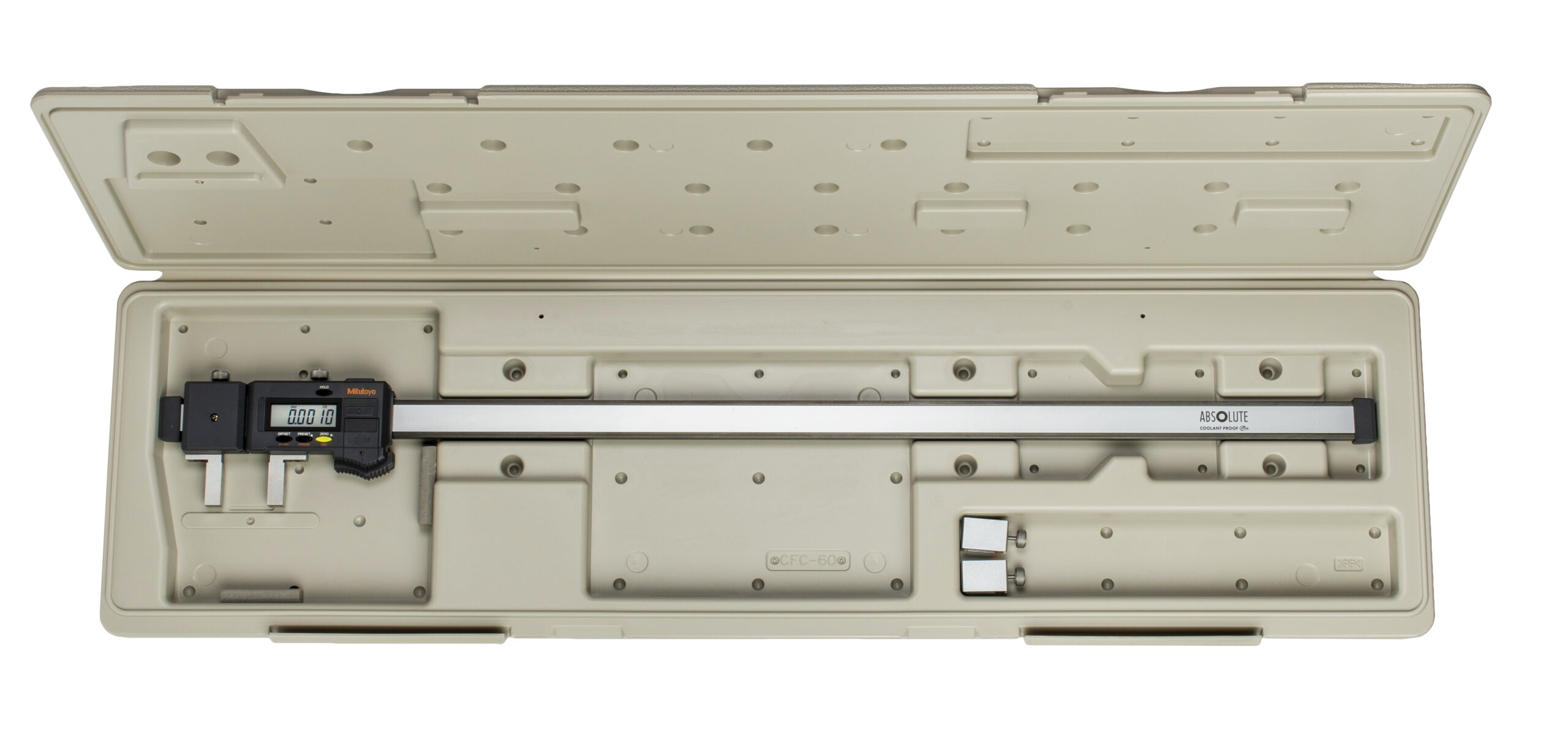

- Supplied in fitted wooden case
