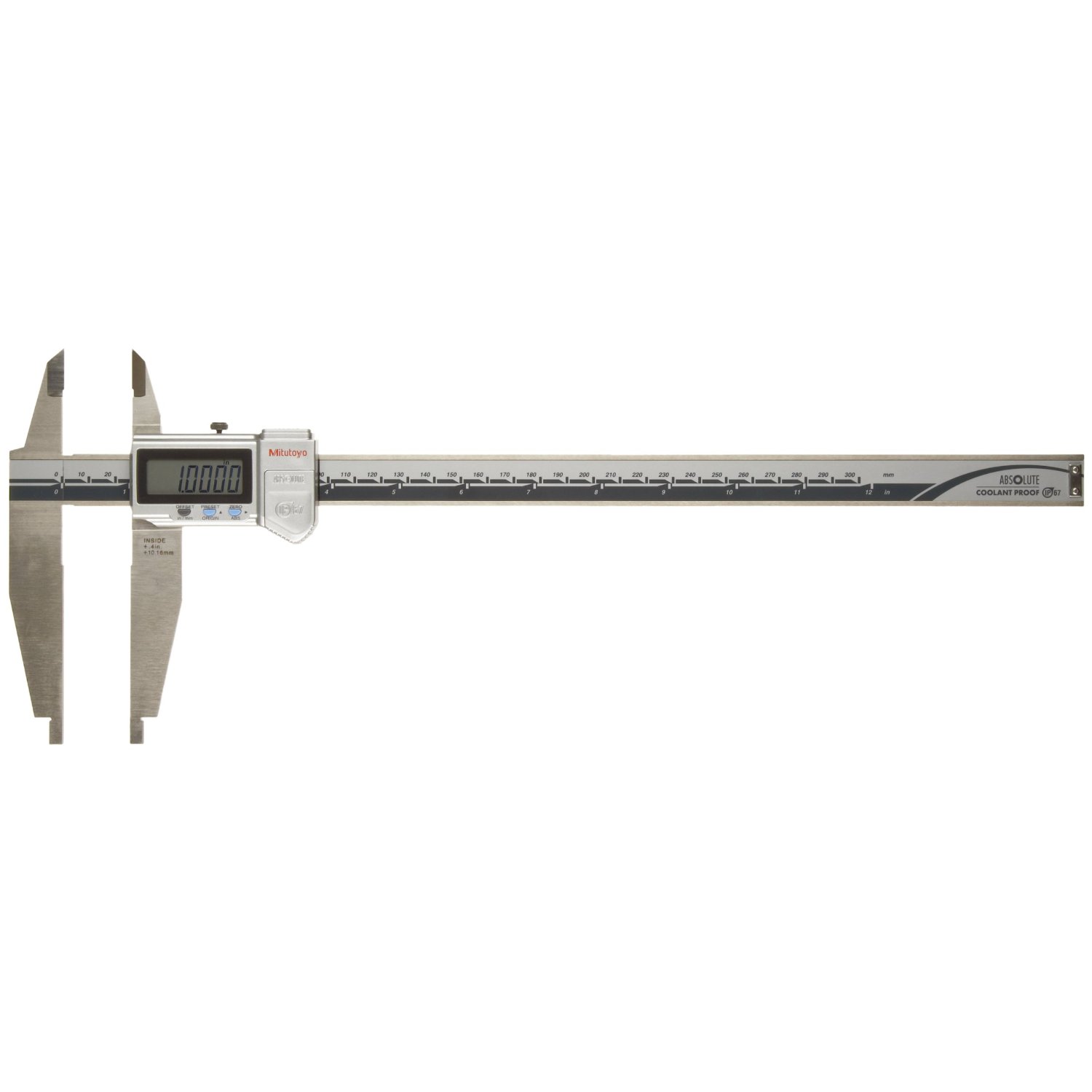

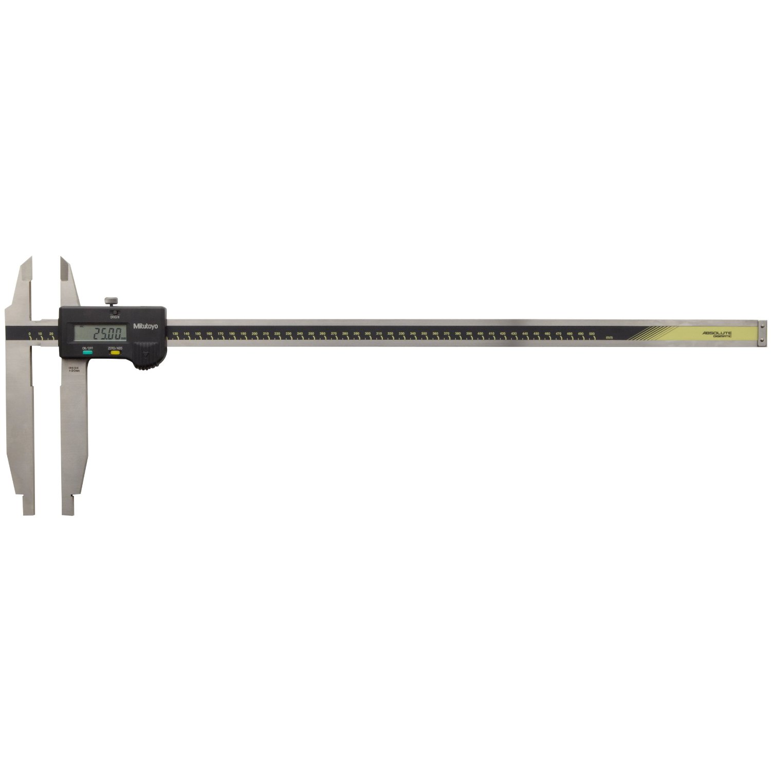

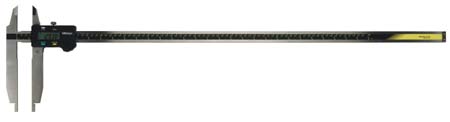

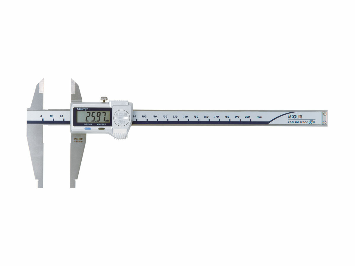

Absolute Digimatic Caliper with Nib Style and Standard Jaws
The Mitutoyo Digimatic caliper with standard and nib-style jaws features upper and lower jaws for precise inside and outside dimension measurements. The measurements are displayed on an easy-to-read LCD read out.
The Mitutoyo Digimatic digital caliber features lower nib style jaws with rounded measuring faces to fit rounded surfaces closer to make highly accurate inside dimension measurements. The upper standard jaws take highly accurate outside dimensions, making this digital caliper highly versatile. The caliper also has a high-resolution Vernier scale with 14-degree face angle to offer easier reading and helps prevent parallax error in the measurement.
  • A fine-adjustment carriage type Vernier caliper is available (Series 160)
  • ABSOLUTE (ABS) linear scale eliminates the need for setting the origin point every time the micrometer is powered on; overspeed errors are also eliminated
  • Functions include Origin Set, Zero Setting, Data Output and inch/mm conversion (on inch/metric models only)
  • Vernier scales are raised to slide easily and protect the graduation markings
  • The caliper is constructed of corrosion-resistant, hardened stainless steel
  • IP67 protection eliminates dust ingress, protects against temporary water submersion; permits use in environments exposed to cutting oil, dust, etc.
  • Unnecessary to wipe or clean the scale
  • Supplied in fitted plastic holster in carton; 450mm/18” and larger models supplied in wooden case
Technology: Digimatic
Length Standard: ABSOLUTE electromagnetic induction type linear encoder
Max Response Speed: Unlimited
Battery: SR44 (1 pc.) 938882
Battery life: Approx. 3.5 years under normal use
SPC Output: Yes
Optional Accessories: 05CZA624, 05CZA625
Order No.: Product Image: Units: IP Rating: Range: Minimum dimension in ID measurement: Resolution: Accuracy: Mass: Offset/preset function:
551-204-10 Metric - 0-500mm 20.1mm 0.01mm ±0.06mm 1060g No
551-206-10 - Metric - 0-750mm 20.1mm 0.01mm ±0.06mm 1410g No
551-207-10 - Metric - 0-1000mm 20.1mm 0.01mm ±0.07mm 3430g No
551-224-10 Metric, Inch - 0-20" 0.50" 0.01mm / 0.0005" ±0.0025" 1060g No
551-226-10 Metric, Inch - 0-30" 0.50" 0.01mm / 0.0005" ±0.0025" 1410g No
551-227-10 Metric, Inch - 0-40" 1.00" 0.01mm / 0.0005" ±0.0030" 3430g No
551-301-20 - Metric IP67 0-200mm 10.1mm 0.01mm ±0.03mm 180g No
551-311-20 - Metric, Inch IP67 0-8" 0.40" 0.01mm / 0.0005" ±0.0015" 180g No
551-331-10 - Metric IP67 0-300mm 10mm - ±0.04mm 380g Y
551-331-20 - Metric IP67 0-300mm 10.1mm 0.01mm ±0.04mm 380g Yes
551-341-10 Metric, Inch IP67 0-12" .4" .0005" ±.002" 380g Y
551-341-20 - Metric, Inch IP67 0-12" 0.40" 0.01mm / 0.0005" ±0.0020" 380g Yes
