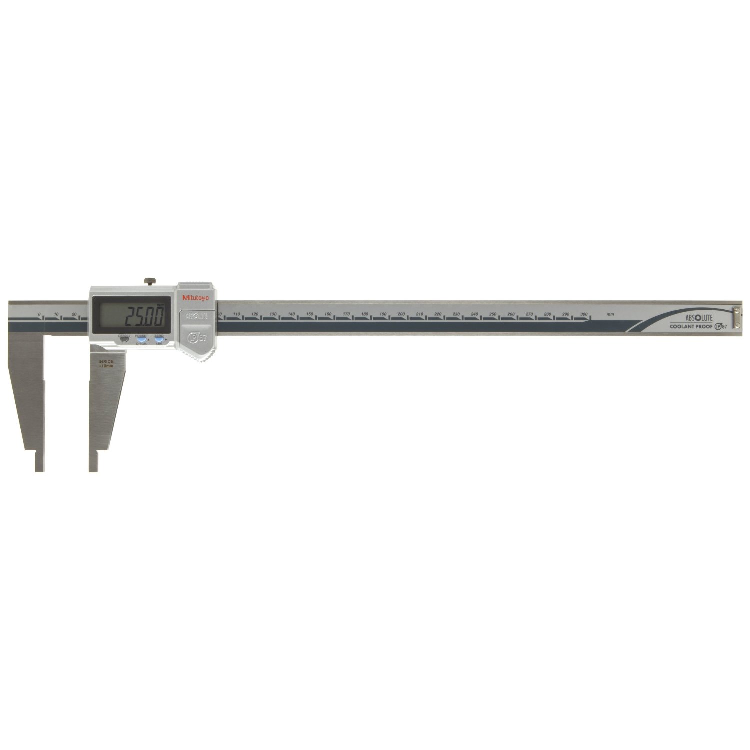

ABSOLUTE Digimatic Caliper with Nib Style Jaws
The Mitutoyo Digimatic caliper with nib style jaws performs inside and outside dimensions with accuracy down to +/-.0.03mm / .001″. Measurements are displayed on an easy-to-read LCD read out.
The Mitutoyo Digimatic digital caliper features nib style jaws with rounded measuring faces to fit rounded surfaces closer to make highly accurate inside dimension measurements.
  • SPC output function offers quick and easy data management in real time
  • ABSOLUTE (ABS) linear scale eliminates the need for setting the origin point every time the micrometer is powered on; overspeed errors are also eliminated
  • Functions include Origin Set, Zero Setting, Data Output and inch/mm conversion (on inch/metric models only)
  • The caliper is constructed of corrosion-resistant, hardened stainless steel
  • IP67 protection eliminates dust ingress, protects against temporary water submersion; permits use in environments exposed to cutting oil, dust, etc.
  • Supplied in fitted plastic case; 1000mm / 40″ model supplied in wooden case
SERIES 550 Technical Data
Technology: Digimatic
Length Standard: ABSOLUTE electromagnetic induction type linear encoder
Max Response Speed: Unlimited
Battery: SR44 (1 pc.) 938882
Battery life: Approx. 5 years under normal use
SPC Output: Yes
Order No.: Product Image: Units: IP Rating: Range: Minimum dimension in ID measurement: Resolution: Accuracy: Mass: Offset/preset function: Optional Accessories:
550-203-10 Metric - 0-450mm 20.1mm 0.01mm ±0.05mm 1110g No -
550-205-10 Metric - 0-600mm 20.1mm 0.01mm ±0.05mm 1290g No -
550-207-10 - Metric - 0-1000mm 20.1mm 0.01mm ±0.07mm 3350g No -
550-223-10 Metric, Inch - 0-450mm / 0-18" 20.1mm / 0.504" 0.01mm / 0.0005" ±0.002" 1110g No -
550-225-10 Metric, Inch - 0-600mm / 0-24" 20.1mm / 0.504" 0.01mm / 0.0005" ±0.002" 1290g No -
550-227-10 Metric, Inch - 0-1000mm / 0-40" 20.1mm / 1.004" 0.01mm / 0.0005" ±0.003" 3350g No -

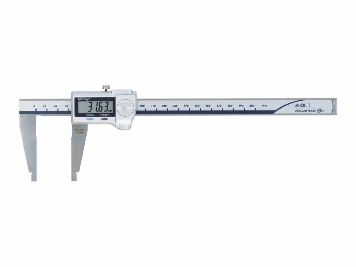

550-301-20 - Metric IP67 0-200mm 10.1mm 0.01mm ±0.03mm 180g No -
550-311-20 - Metric, Inch IP67 0-200mm / 0-8" 10.1mm / 0.404" 0.01mm / 0.0005" ±0.0015" 180g No -
550-331-10 - Metric IP67 0-300mm 10.1mm 0.01mm ±0.03mm 380g Yes -
550-341-10 Metric, Inch IP67 0-300mm / 0-12" 10.1mm / 0.404" 0.01mm / 0.0005" ±0.002" 380g Yes -
