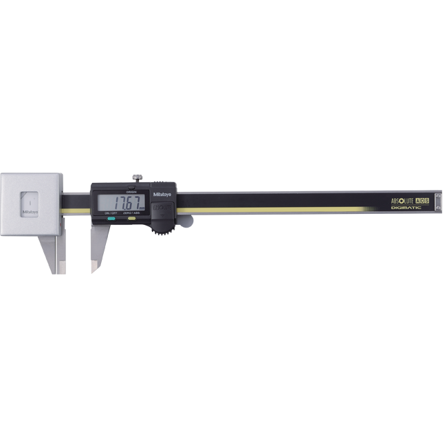

ABSOLUTE Digimatic Low Force Caliper
The Mitutoyo ABSOLUTE Digimatic Low Force caliper is specially designed to measure parts made of softer materials such as plastic or rubber with precision. Measurements are displayed on a digital LCD readout with SPC output for easy, automatic recording.
The Mitutoyo ABSOLUTE Digimatic Low Force caliper uses a low measuring force to take highly accurate measurements of resilient workpieces that standard calipers cannot measure. The lower measuring force greatly reduces the compression of materials such as elastic, plastic and rubber, providing a more precise, repeatable measurement. A consistently low measuring force  is guaranteed by only taking measurements when the pointer on the caliper is between two fiducial lines.
  • Measures pieces that standard calipers cannot measure
  • Range is 0-180mm/0-7” with accuracy rated at +/- 0.05mm
  • SPC output function offers quick and easy data management in real time
  • ABSOLUTE (ABS) linear scale eliminates the need for setting the origin point every time the micrometer is powered on; overspeed errors are also eliminated
  • Functions include Origin Set, Zero Setting, Power On/Off, Data Output and inch/mm conversion (on inch/metric models only)
  • Constructed of hardened stainless steel for better durability and longevity
Technology: Digimatic
Length Standard: ABSOLUTE electromagnetic induction type linear encoder
Max Response Speed: Unlimited
Battery: SR44 (1 pc.) 938882
Battery life: Approx. 3.5 years under normal use
SPC Output: Yes
Mass: 253g
Min Measuring Force: 0.5N
Max Measuring Force: 1N
Jaw retraction: 0.3mm
Optional Accessories: 959143, 959149, 959150
