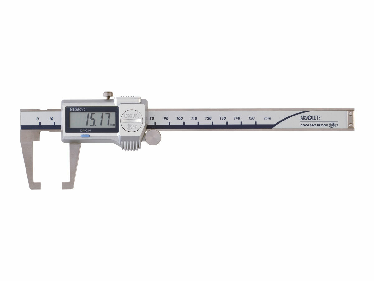

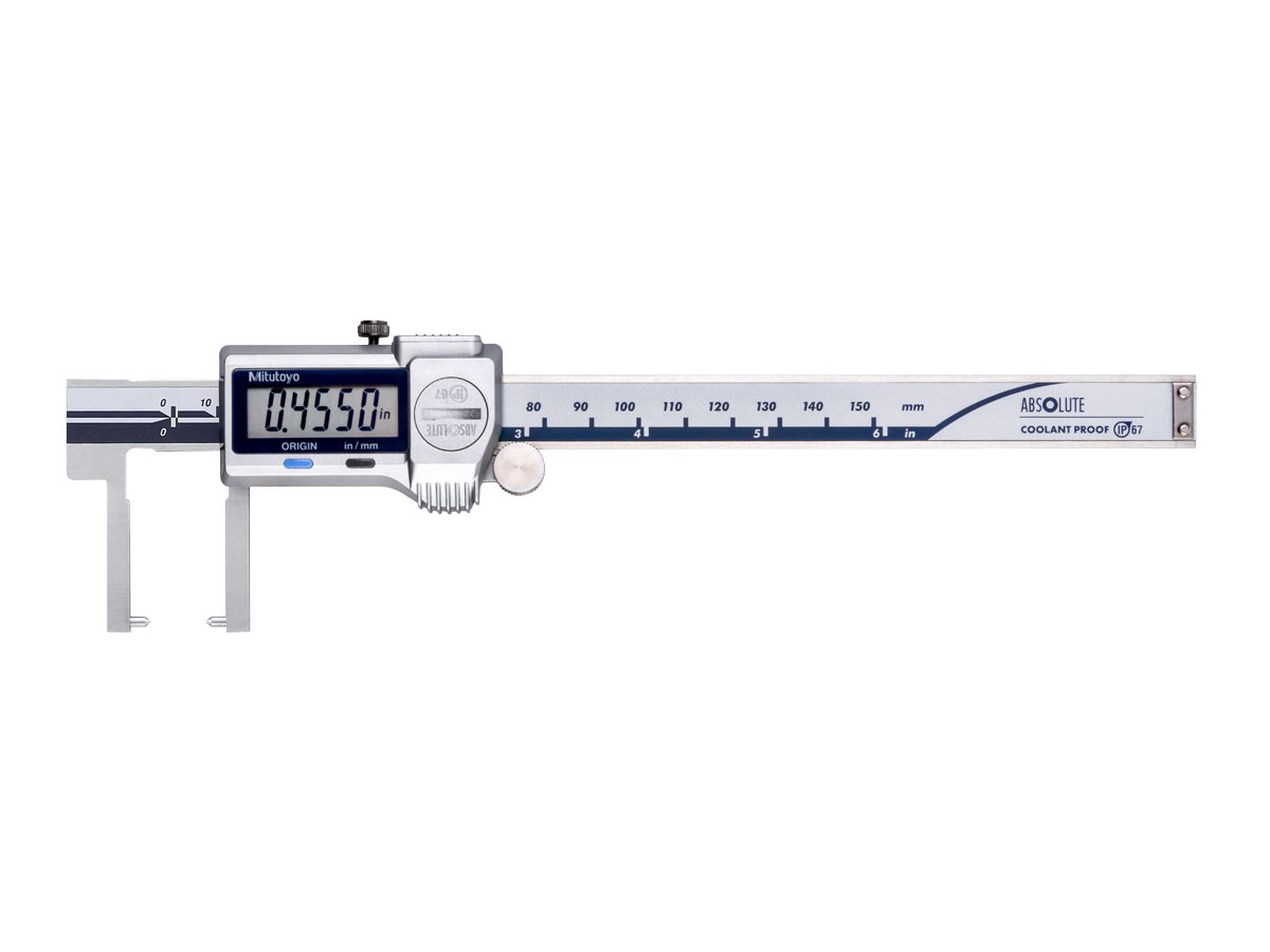

The Mitutoyo ABSOLUTE Digimatic Neck Caliper is available with either point or flat-type jaws to attain highly accurate measurements of neck parts on a workpiece. Measurements are displayed on a digital LCD readout with SPC output for easy, automatic recording.

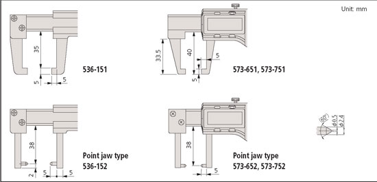

The Mitutoyo ABSOLUTE Digimatic Neck Caliper is available with either point-type or flat-type jaws. Equipped with point-type jaws, this neck caliper takes accurate measurements of wall thickness inside bores and recesses. Flat-jaw type calipers measure outside dimensions of grooves and recesses. The neck caliper is constructed of hardened stainless steel and is IP67 rated for exceptional coolant-proof capabilities, making this caliper ideal on the shop floor.

| Order No.: | Product Image: | Units: | Range: | Resolution: | Accuracy: | Remarks: |
| 573-651-20 | - | Metric | 0-150mm | 0.01mm | ±0.03mm | - |
| 573-652-20 | - | Metric | 0-150mm | 0.01mm | ±0.03mm | Point-jaw type |
| 573-751-20 | - | Metric, Inch | 0-150mm / 0-6" | 0.01mm / 0.0005" | ±0.0015" | - |
| 573-752-20 | - | Metric, Inch | 0-150mm / 0-6" | 0.01mm / 0.0005" | ±0.0015" | Point-jaw type |
