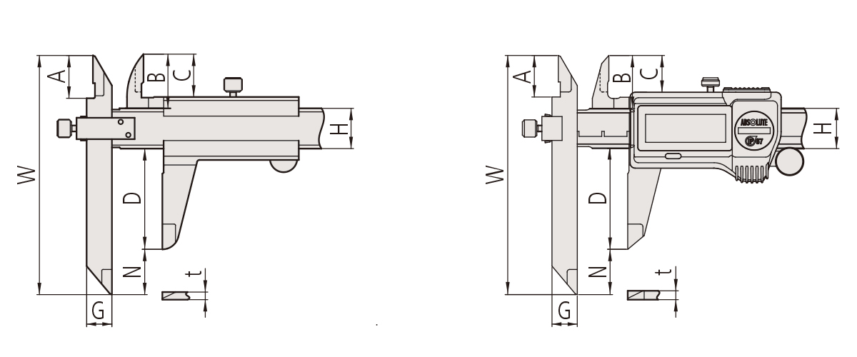

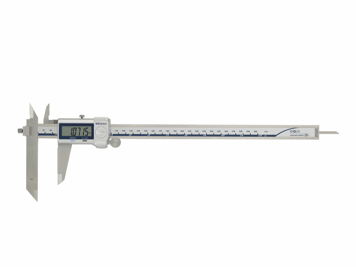

The Mitutoyo ABSOLUTE Digimatic Offset caliper is designed to take highly accurate measurements of hard-to-access stepped sections. Measurements are displayed on a digital LCD readout with SPC output for easier, automatic recording.
The Mitutoyo ABSOLUTE Digimatic Offset caliper features sliding main scale jaws which allow for measurement of stepped sections and other hard-to-reach grooves or features. The offset caliper is constructed of hardened stainless steel and is IP67 rated for exceptional coolant-proof capabilities, making this caliper ideal on the shop floor.
- Functions include Origin Set, Zero Setting, Power On/Off, Data Output and inch/mm conversion (on inch/metric models only)
- Constructed of hardened stainless steel for better durability and longevity
- IP67 protection eliminates dust ingress, protects against temporary water submersion; allows use in environments exposed to cutting oil, dust, etc.
- Unnecessary to wipe or clean the scale
