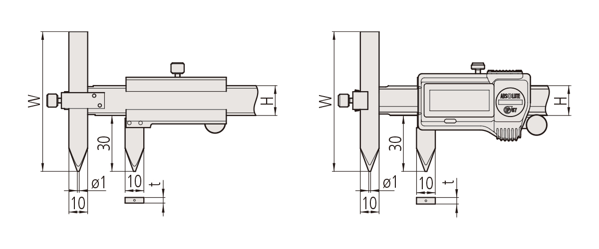

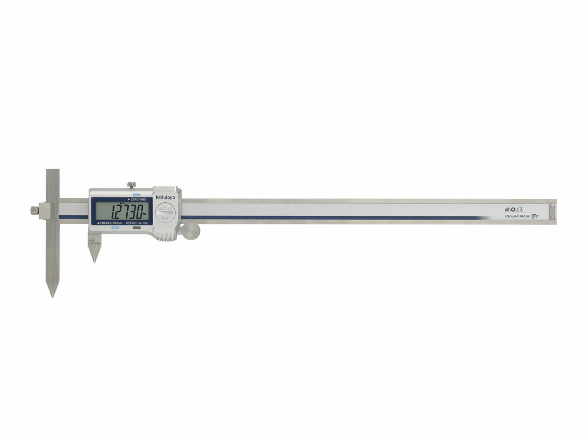

The Mitutoyo ABSOLUTE Digimatic Offset Centerline caliper is specially designed to measure center-to-center distances on the same or offset planes. Measurements are displayed on a digital LCD readout with SPC output for easy, automatic recording.
The Mitutoyo ABSOLUTE Digimatic Offset Centerline caliper features main scale jaws that adjust up and down to measure unlevel (different planes) center-to-center distances. The offset centerline caliper takes highly accurate center-to-center measurements and hole diameters of 1.55mm to 10mm. The centerline caliper is constructed of hardened stainless steel and is IP67 rated for exceptional coolant-proof capabilities, making this caliper ideal on the shop floor.
- Functions include Origin Set, Zero Setting, Power On/Off, Data Output and inch/mm conversion (on inch/metric models only)
- Constructed of hardened stainless steel for better durability and longevity
- IP67 protection eliminates dust ingress, protects against temporary water submersion; permits use in environments exposed to cutting oil, dust, etc.
- Unnecessary to wipe or clean the scale
