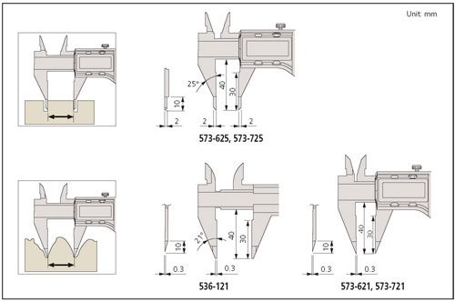

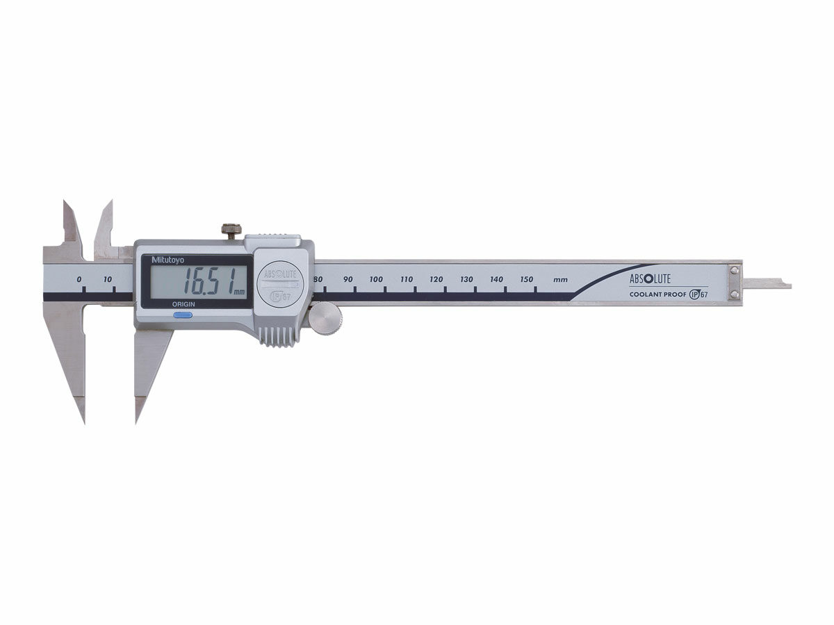

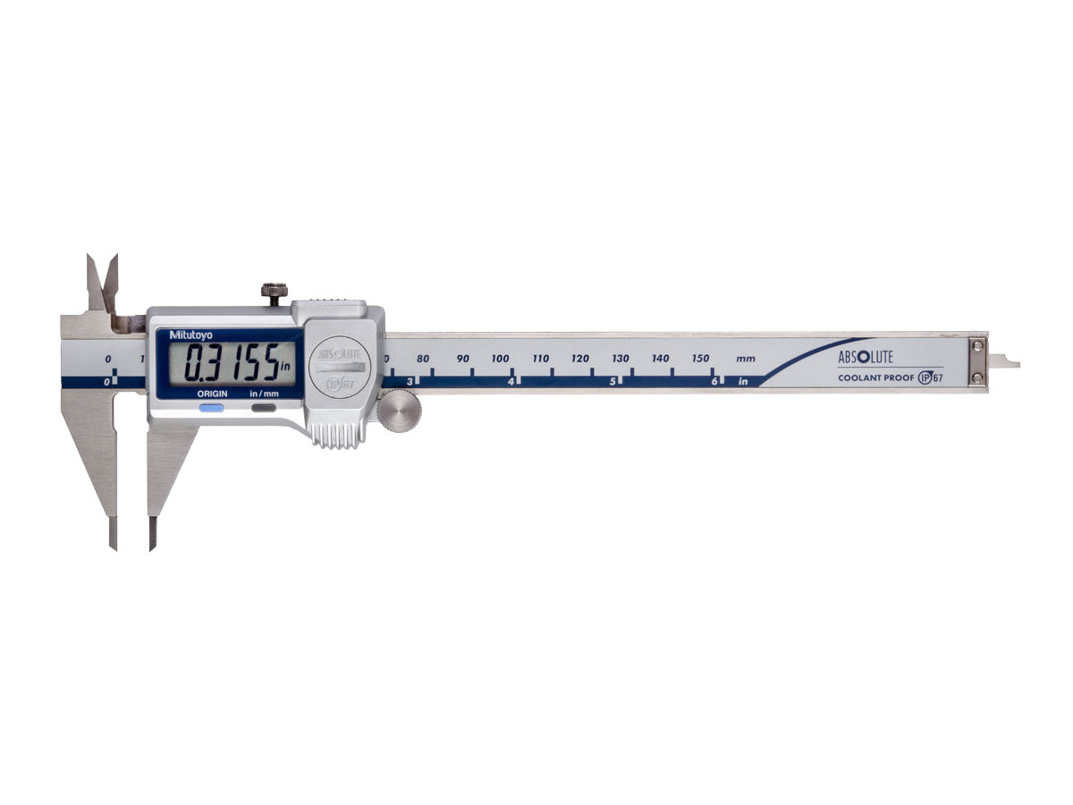

The Mitutoyo ABSOLUTE Digimatic Point Caliper uses narrow-tipped jaws to measure very small grooves and tracks. Measurements are displayed on a digital LCD readout with SPC output for easy, automatic recording.
The Mitutoyo ABSOLUTE Digimatic Point Caliper features jaws with narrow tips to attain difficult outside measurements. The narrow-tipped jaws are capable of measuring the inside of very small grooves and tracks. The point caliper is constructed of hardened stainless steel and is IP67 rated for exceptional coolant-proof capabilities, making this caliper ideal on the shop floor.
- Depth bar makes accurate step measurements quick and easy
- Functions include Origin Set, Zero Setting, Power On/Off, Data Output and inch/mm conversion (on inch/metric models only)
- Constructed of hardened stainless steel for better durability and longevity
- Includes a Mitutoyo Certificate of Calibration verifying that the tool has been calibrated and meets the International Organization for Standardization/International Electrotechnical Commission (ISO/IEC) 17025 International Standard for testing and calibration laboratories
- IP67 protection eliminates dust ingress, protects against temporary water submersion; permits use in environments exposed to cutting oil, dust, etc.
- Unnecessary to wipe or clean the scale
| Technology: | Digimatic |
| Length Standard: | ABSOLUTE electromagnetic induction type linear encoder |
| Display: | LCD |
| IP Rating: | IP67 |
| SPC Output: | Yes |
| Mass: | 163g |
| Optional Accessories: | 05CZA624, 05CZA625 |
| Order No.: | Product Image: | Units: | Range: | Resolution: | Accuracy: |
| 573-621-20 | - | Metric | 0-150mm | 0.01mm | ±0.02mm |
| 573-625-20 | - | Metric | 0-150mm | 0.01mm | ±0.02mm |
| 573-721-20 | - | Metric, Inch | 0-150mm / 0-6" | 0.01mm / 0.0005" | ±0.001" |
| 573-725-20 | - | Metric, Inch | 0-150mm / 0-6" | 0.01mm / 0.0005" | ±0.001" |
