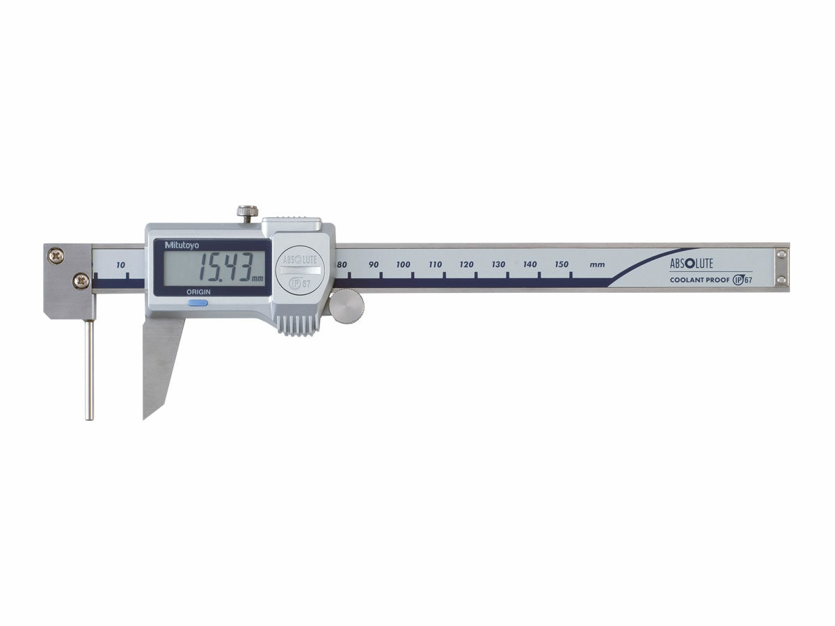

The Mitutoyo ABSOLUTE Digimatic Tube Thickness caliper features a round bar and flat jaw to measure the wall thickness of tubes, pipes and other round parts. Measurements are displayed on a digital LCD readout with SPC output for easy, automatic recording.
The Mitutoyo ABSOLUTE Digimatic Tube Thickness caliper has a main scale which consists of a round bar and blade-type jaw constructed of hardened steel to take highly accurate wall thickness measurements of round pieces. The round bar allows the jaw to match the rounded contour of tubes and pipes for precise measurements. The neck caliper is constructed of hardened stainless steel and is IP67 rated for exceptional coolant-proof capabilities, making this caliper ideal on the shop floor.
- Range is 0-150mm with accuracy rated at +/- 0.05mm
- Functions include Origin Set, Zero Setting, Power On/Off, Data Output and inch/mm conversion (on inch/metric models only)
- Constructed of hardened stainless steel for better durability and longevity
- IP67 protection eliminates dust ingress, protects against temporary water submersion; permits use in environments exposed to cutting oil, dust, etc.
- Unnecessary to wipe or clean the scale

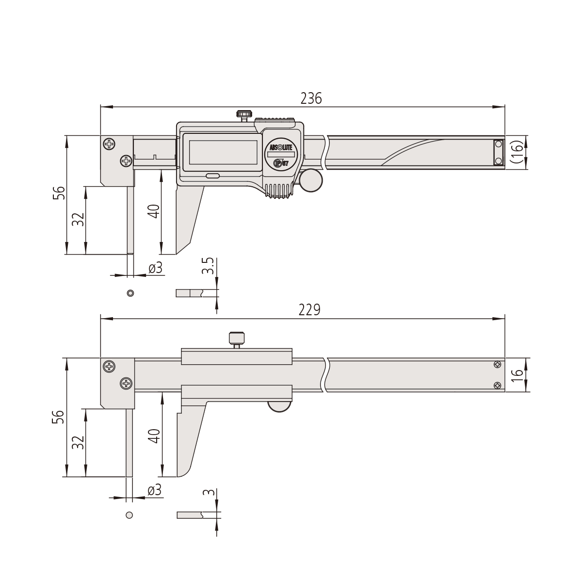

| Mass: | 167g |
| Optional Accessories: | 05CZA624, 05CZA625 |
| Order No.: | Product Image: | Units: | Range: | Resolution: | Accuracy: |
| 573-661-20 | - | Metric | 0-150mm | 0.01mm | ±0.05mm |
| 573-761-20 | - | Metric, Inch | 0-150mm / 0-6" | 0.01mm / 0.0005" | ±0.002" |
