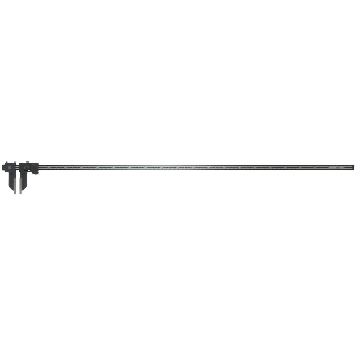

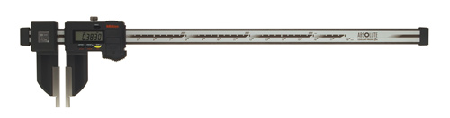

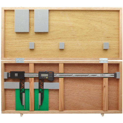

Digimatic Carbon Fiber Caliper
The Mitutoyo Digimatic carbon fiber caliper with optional jaw attachments uses reinforced carbon fiber plastics (CFRP) in the beam and jaws to create a lightweight, highly durable caliper for accurate inside and outside dimension measurements.
The Mitutoyo digital carbon fiber lower nib style jaws with rounded measuring faces fit rounded surfaces closer to make highly accurate inside dimension measurements. The upper standard jaws take highly accurate outside dimensions, making this digital caliper highly versatile. The measurements are displayed on an easy-to-read LCD read out.
  • Special models with ceramic jaws which are suitable for measuring abrasive and magnetic products are available
  • SPC output function offers quick and easy data management in real time
  • ABSOLUTE (ABS) linear scale eliminates the need for setting the origin point every time the micrometer is powered on; overspeed errors are also eliminated
  • Functions include Origin Set, Zero Setting, Presetting, Offsetting, Data Hold, Data Output and inch/mm conversion (on inch/metric models only)
  • Constructed of lightweight, durable carbon fiber composites
  • IP66 protection eliminates dust ingress, protects against high pressure jets; permits use in environments exposed to cutting oil, dust, etc.
  • Unnecessary to wipe or clean the scale

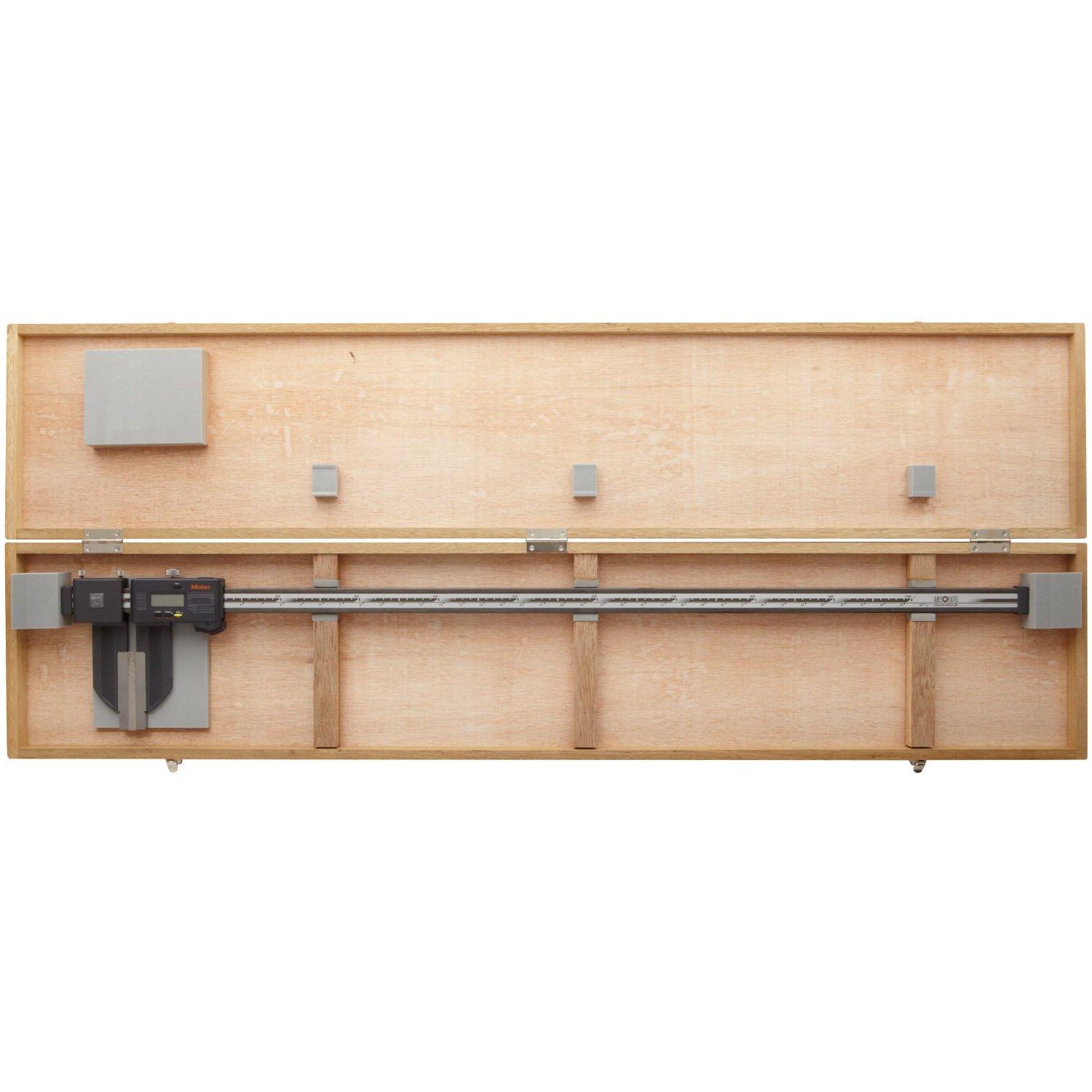

  • Supplied in fitted wooden case

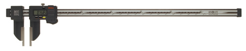

SERIES 552 Technical Data
Technology: Digimatic
Length Standard: ABSOLUTE electromagnetic induction type linear encoder
Max Response Speed: Unlimited
Battery: SR44 (1 pc.) 938882
Battery life: Approx. 5,000 hours under normal use
IP Rating: IP66
SPC Output: Yes

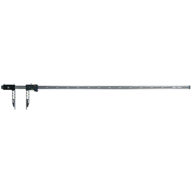

Order No.: Product Image: Units: Range: Minimum dimension in ID measurement: Resolution: Accuracy: Mass: Remarks: Optional Accessories:
552-150-10 Metric 0-450mm 20.1mm 0.01mm ±0.06mm 1215g long jaws 200mm -
552-151-10 Metric 0-600mm 20.1mm 0.01mm ±0.06mm 1290g long jaws 200mm -
552-152-10 - Metric 0-1000mm 20.1mm 0.01mm ±0.07mm 2090g long jaws 200mm -
552-153-10 Metric 0-1500mm 20.1mm 0.01mm ±0.11mm 2490g long jaws 200mm -
552-154-10 - Metric 0-2000mm 20.1mm 0.01mm ±0.14mm 2890g long jaws 200mm -
