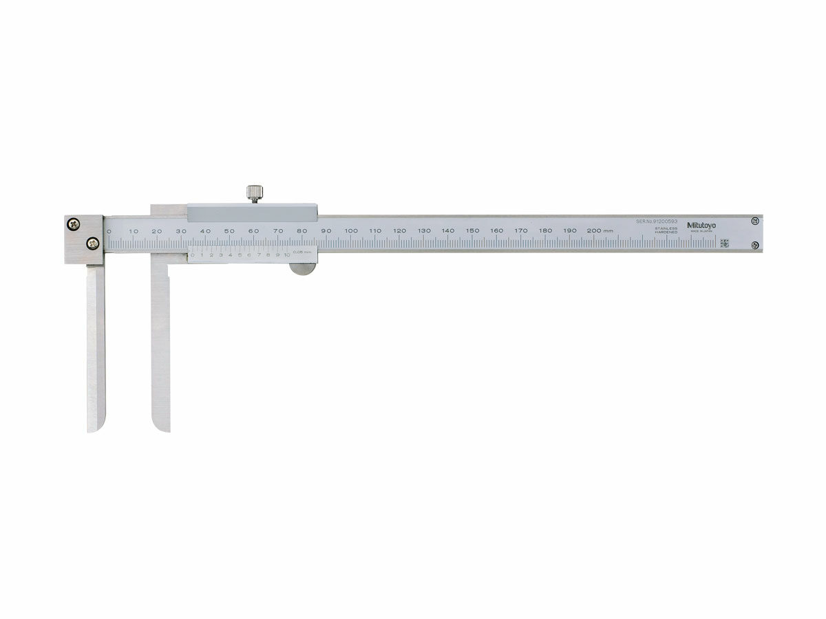

Vernier Inside Caliper
The Mitutoyo Vernier specialized inside caliper is available with either point, knife-edge or inside groove jaws to obtain highly accurate inside measurements in hard to reach spaces.
The Mitutoyo Vernier Specialized Inside Caliper is specially designed to measure inside dimensions that are otherwise hard to obtain with standard calipers. Available in point-type, knife-edge or inside groove jaws, this specialized caliper is capable of reaching into recesses, bore holes and grooves and provides precise, repeatable measurements. The caliper is constructed of hardened stainless steel with a satin chrome finish for protection and easy reading.

Order No.: Product Image: Units: Range: Accuracy: Mass: Measurable minimum hole diameter: Remarks:
536-142 Metric 10-200mm ±0.12mm 210g Ø10mm Knife-edge type
536-145 Metric 10.1-150mm ±0.05mm 130g Ø10mm Inside-groove type
536-146 Metric 20.1-150mm ±0.05mm 140g Ø20mm Point-jaw type
536-147 - Metric 30.1-300mm ±0.08mm 370g Ø30mm Point-jaw type
536-148 - Metric 70.1-450mm ±0.10mm 1250g Ø70mm Point-jaw type
536-149 - Metric 70.1-600mm ±0.12mm 1430g Ø70mm Point-jaw type
