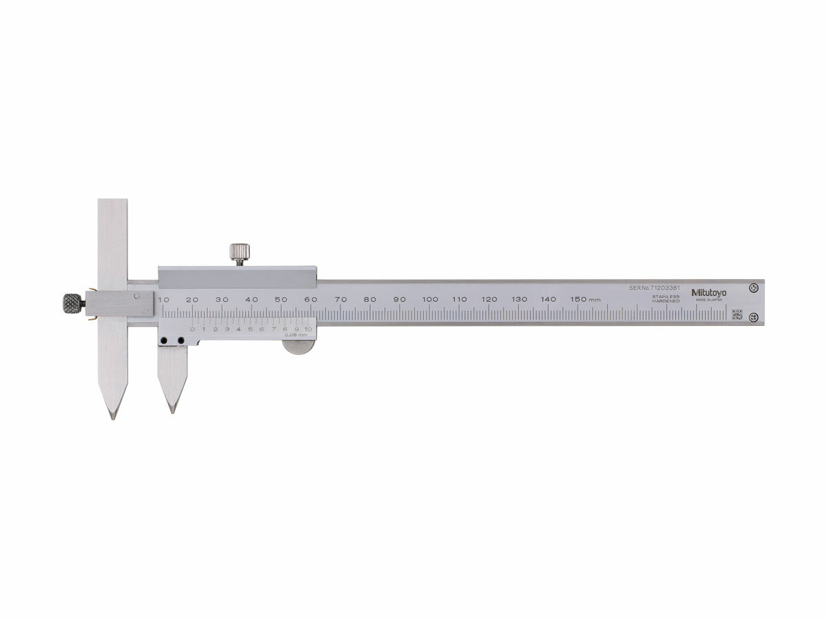

Vernier Offset Centerline Caliper
The Mitutoyo Vernier Offset caliper measures center-to-center distances on the same and different planes, as well as hard-to-reach step dimensions, with high accuracy.
The Mitutoyo Vernier Offset caliper features main scale jaws which adjust up and down to measure center-to-center distances that are not level. This caliper also takes highly accurate edge-to-center measurements with hole diameters of 1.55mm to 10mm.  Offers dual metric reading scales for taking measurements and features raised sliding surfaces which prevent defacement and wear of scale graduations. The offset caliper is constructed of hardened stainless steel that resists corrosion for longer, more accurate use.
  • Available in Metric models
  • Constructed  of corrosion-resistant, hardened stainless steel
  • Lock screw holds the sliding jaw position for accurate measurement
Technology: Mechanical
Units: Metric
Graduation: 0.05mm
Order No.: Product Image: Units: Range: Accuracy: Mass:
536-105 Metric 10.1-150mm ±0.05mm 140g
536-106 - Metric 10.1-200mm ±0.05mm 160g
536-107 - Metric 10.1-300mm ±0.08mm 320g
