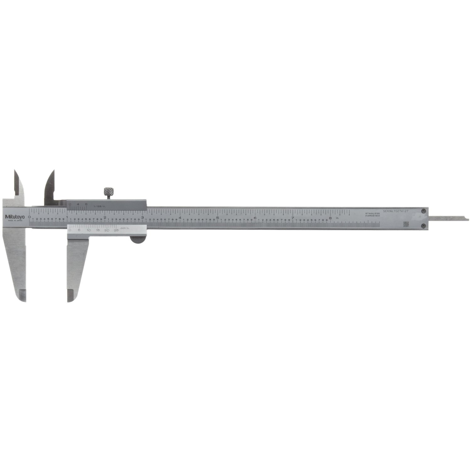

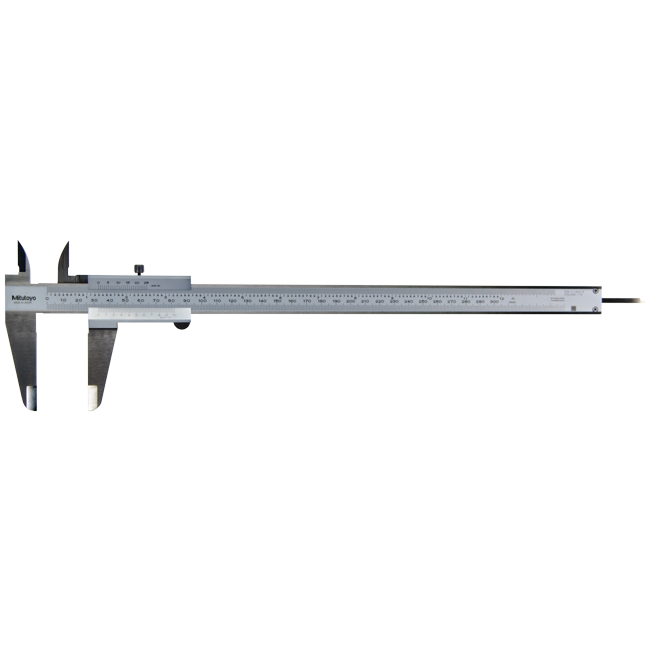

The Mitutoyo Vernier caliper measures inside, outside, step and depth (with depth bar) dimensions with exceptional accuracy where high precision is a necessity.
The Mitutoyo Vernier caliper features a 14-degree face angle for easier reading and helps prevent parallax error in the measurement. The scales are raised to slide easily and protect the graduation markings. The Vernier caliper is constructed of hardened stainless steel that is corrosion resistant and a satin chrome finish reduces glare.
  • Available in Metric, Inch and Metric/Inch models
  • Inch and Metric/Inch models have dual reading Vernier scales
  • Carbide-tipped jaws are available
  • The Vernier caliper is constructed of corrosion-resistant stainless steel
  • Lock screw holds the sliding jaw position to obtain accurate measurement
  • Most models are supplied with a vinyl holster in a fitted plastic case
  • The 600mm / 24″ models are supplied in a carton
  • The 1000mm / 40″ models are supplied in a wooden case

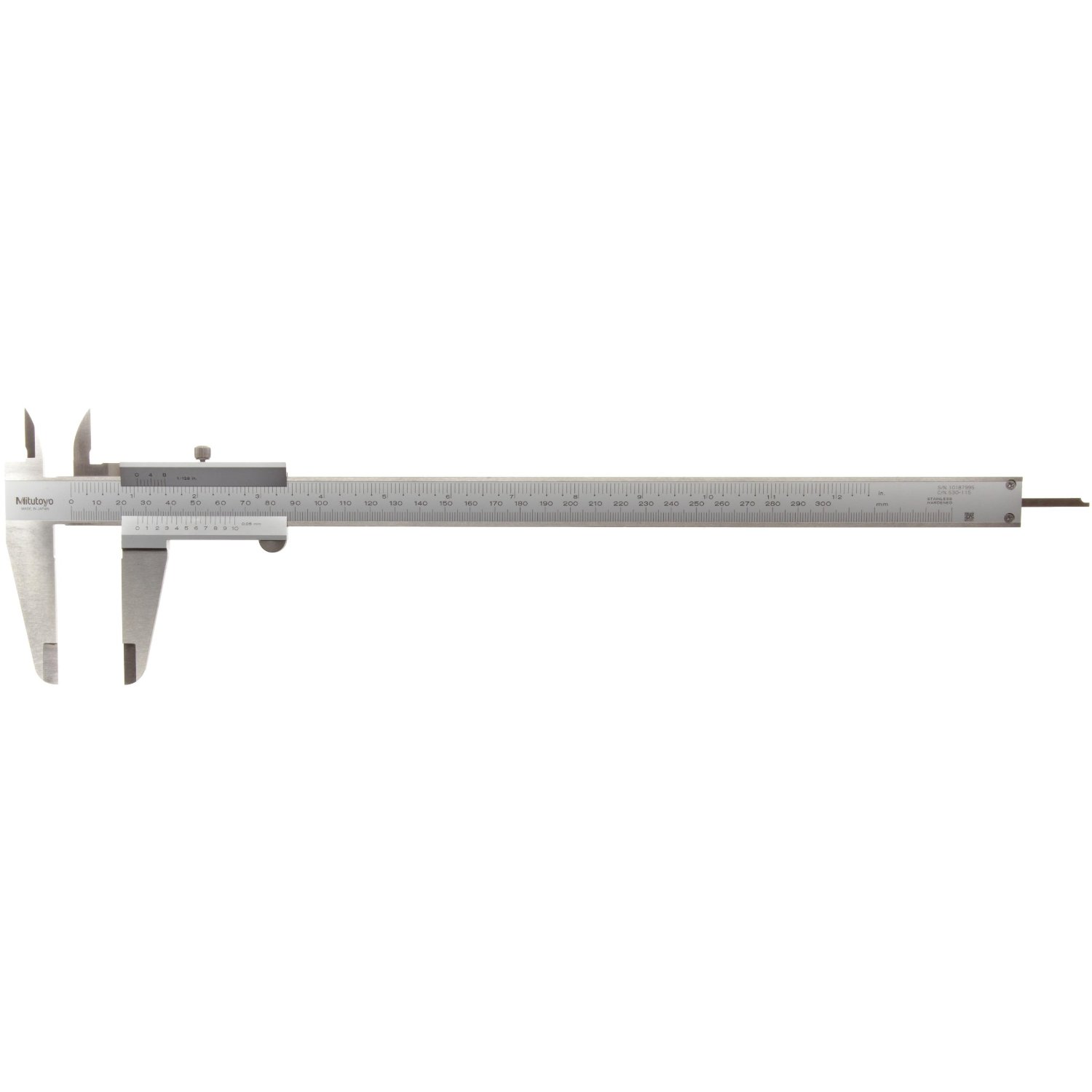

SERIES 530 Technical Data
Technology: Mechanical
Order No.: Product Image: Units: Range: Accuracy: Mass: Graduation: Graduation Lower Scale: Graduation Upper Scale: Depth measuring bar: Remarks:

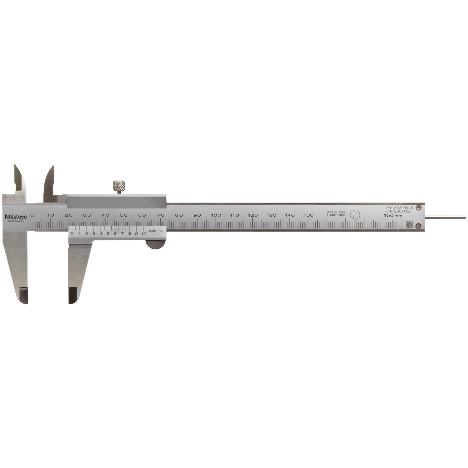

530-101 Metric 0-150mm ±0.05mm 143g 0.05mm - - Yes -
530-102 Metric 0-150mm ±0.05mm 143g 0.05mm - - Yes ø1.9mm depth bar

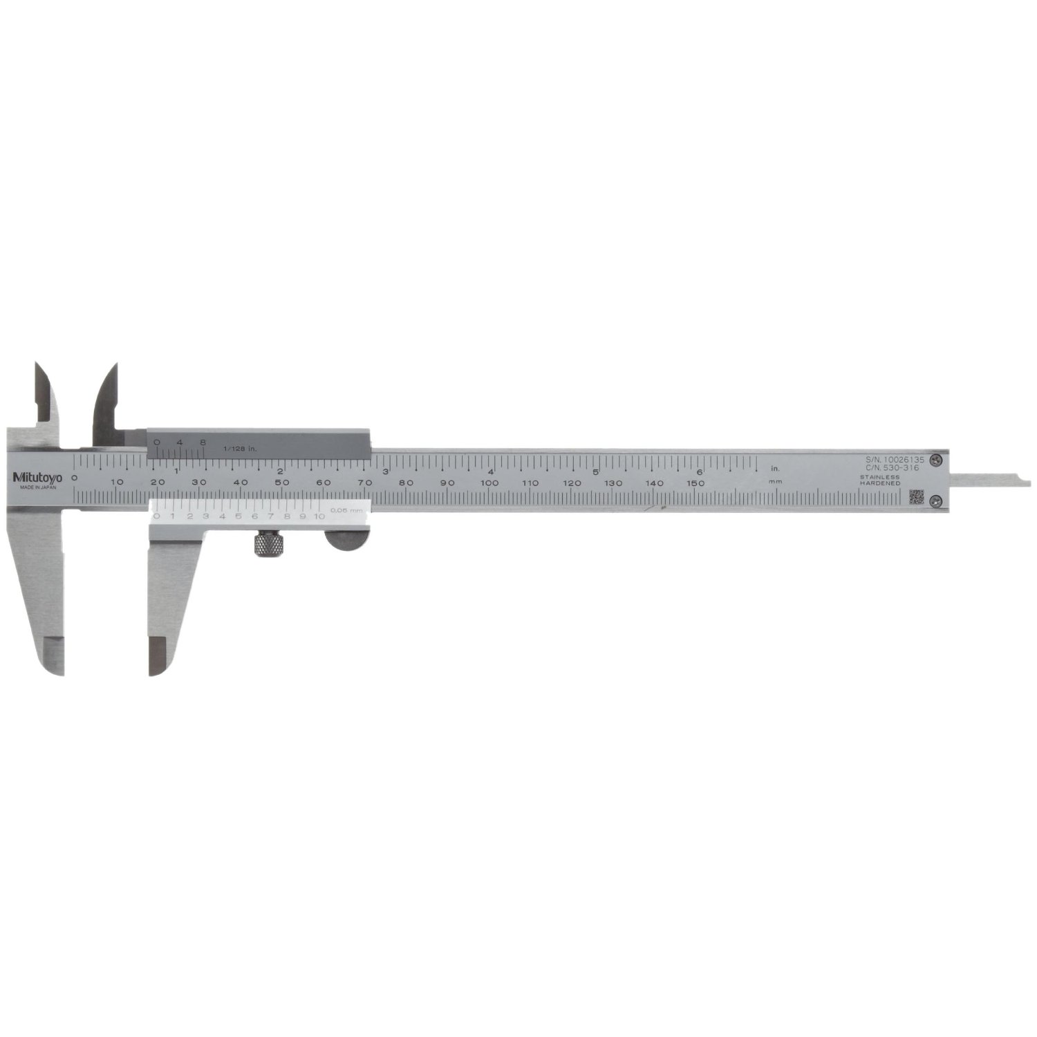

530-104 Metric, Inch 0-150mm / 0-6" ±0.05mm 143g - 0.05mm 1/128" Yes -
530-105 Inch 0-6" ±0.0015" 143g - - - Yes -

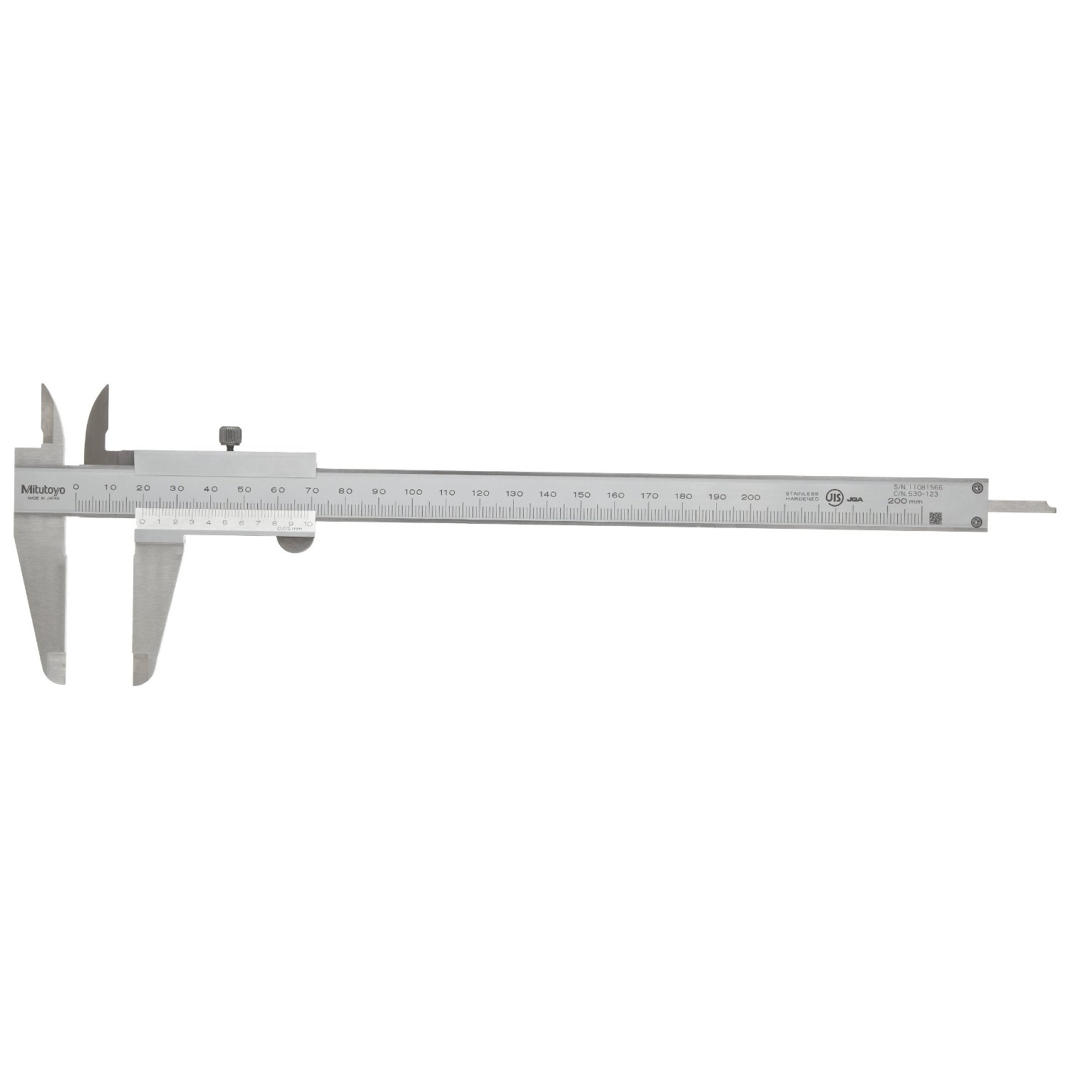

530-108 Metric 0-200mm ±0.05mm 180g 0.05mm - - Yes -
530-109 Metric 0-300mm ±0.08mm 335g 0.05mm - - Yes -

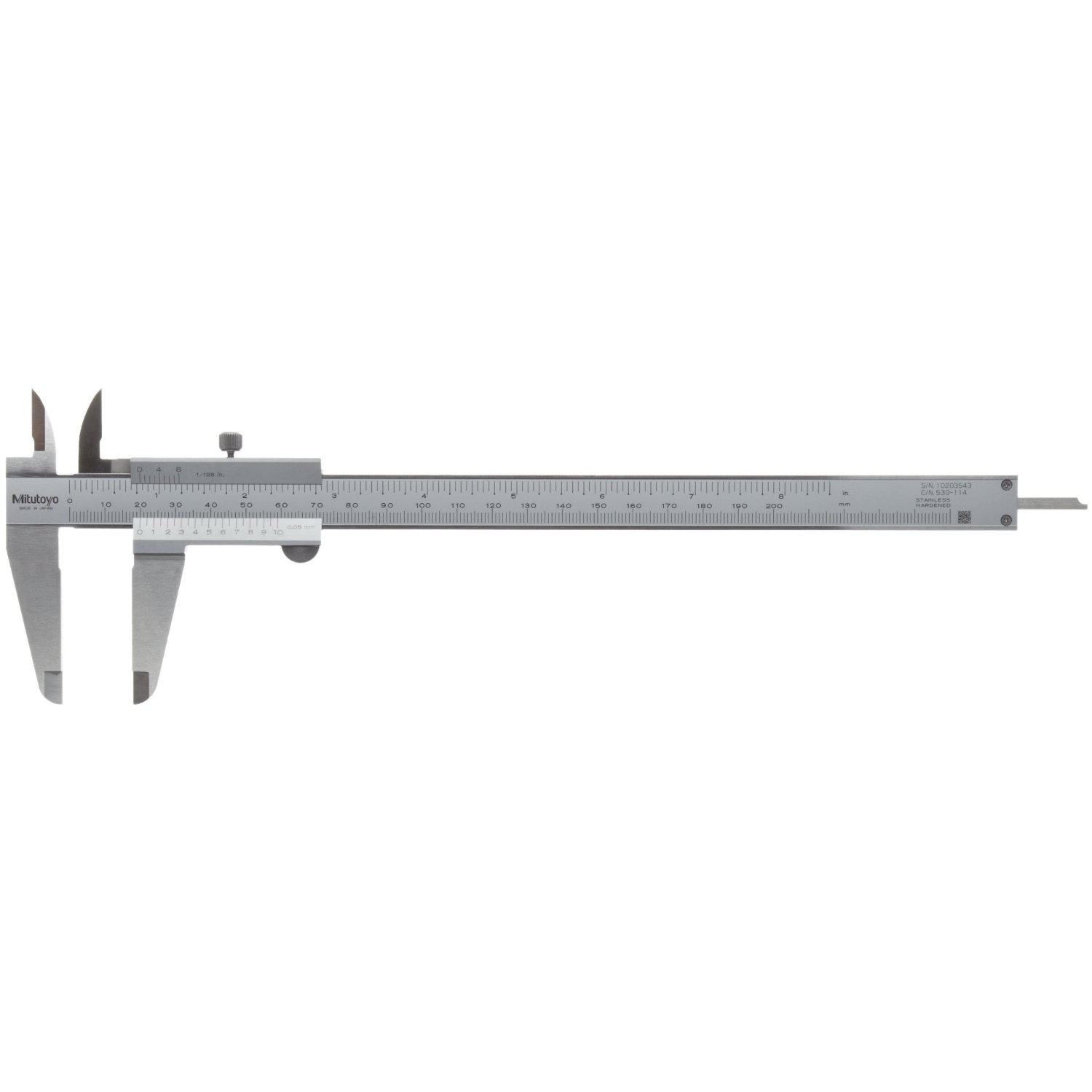

530-114 Metric, Inch 0-200mm / 0-8" ±0.05mm 180g - 0.05mm 1/128" Yes -
530-115 Metric, Inch 0-300mm / 0-12" ±0.08mm 335g - 0.05mm 1/128" Yes -
530-116 Inch 0-8" ±0.0015" 180g - - - Yes -
530-118 Metric, Inch 0-200mm / 0-8" ±0.03mm 180g - 0.02mm .001" Yes High-accuracy model
530-119 Metric, Inch 0-300mm / 0-12" ±0.04mm 335g - 0.02mm .001" Yes High-accuracy model
530-122 Metric 0-150mm ±0.03mm 143g 0.02mm - - Yes High-accuracy model
530-123 Metric 0-200mm ±0.03mm 180g 0.02mm - - Yes High-accuracy model
530-124 Metric 0-300mm ±0.04mm 335g 0.02mm - - Yes High-accuracy model
530-312 Metric, Inch 0-150mm / 0-6" ±0.03mm 143g - 0.02mm .001" Yes High-accuracy model
530-316 Metric, Inch 0-150mm / 0-6" ±0.05mm 143g - 0.05mm 1/128" Yes -
530-320 Metric 0-150mm ±0.05mm 143g 0.05mm - - Yes Carbide-tipped jaws for OD measurement
530-321 Metric 0-200mm ±0.05mm 180g 0.05mm - - Yes Carbide-tipped jaws for OD measurement
530-322 Metric 0-300mm ±0.08mm 335g 0.05mm - - Yes Carbide-tipped jaws for OD measurement
530-335 Metric 0-150mm ±0.05mm 143g 0.05mm - - Yes Carbide-tipped jaws for OD & ID measurement

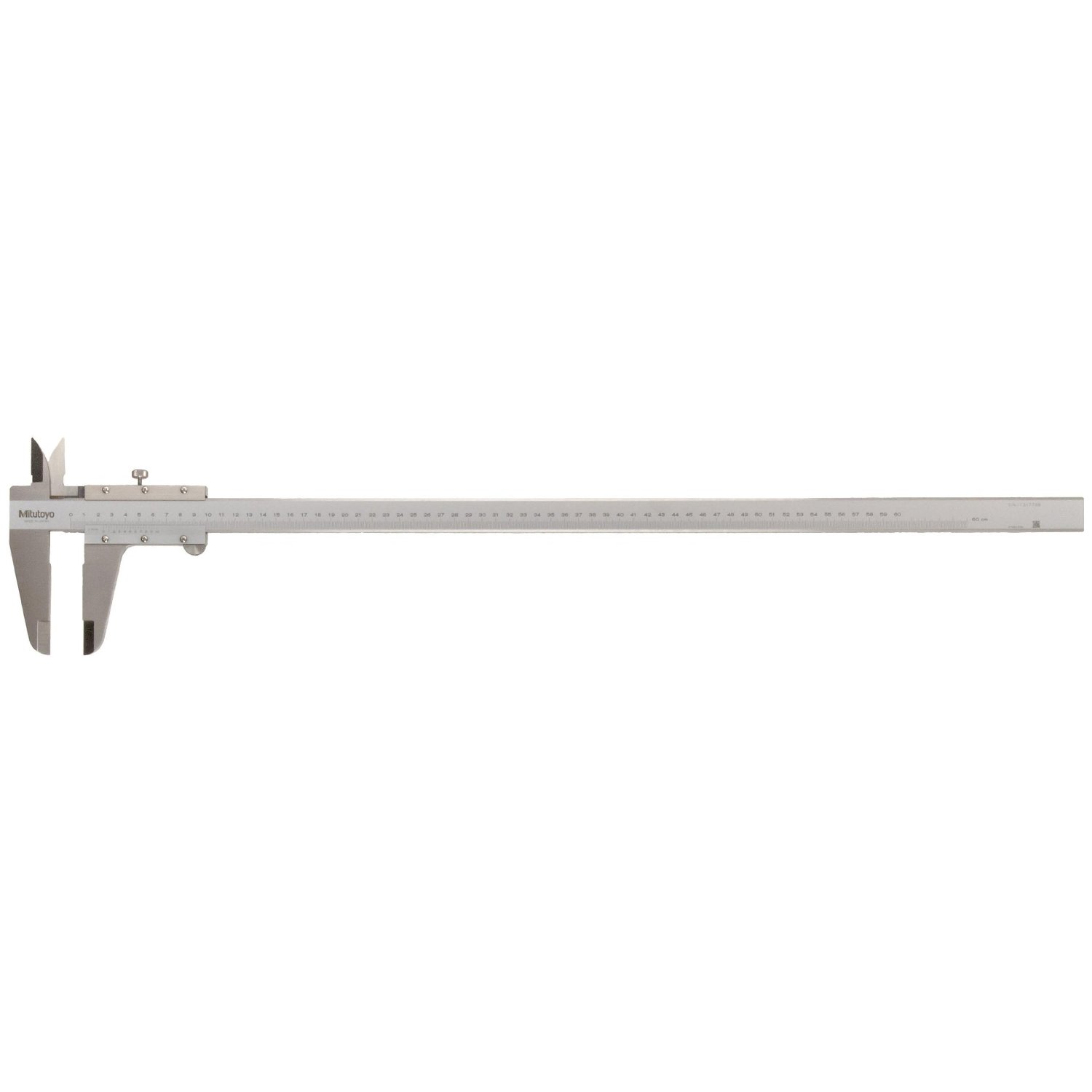

530-501 Metric 0-600mm ±0.1mm 1300g 0.05mm - - - -
530-502 Metric 0-1000mm ±0.15mm 3300g 0.05mm - - - -
