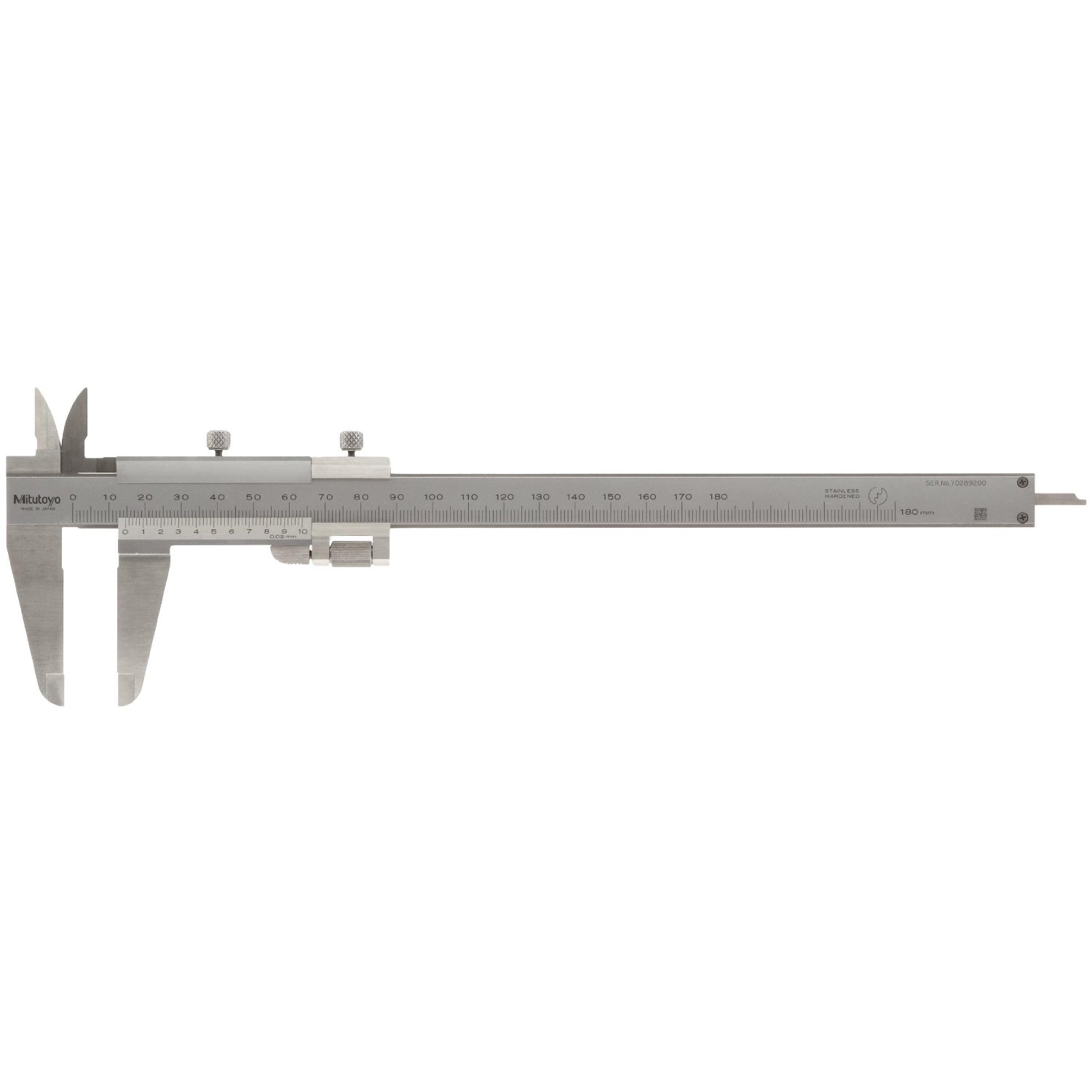

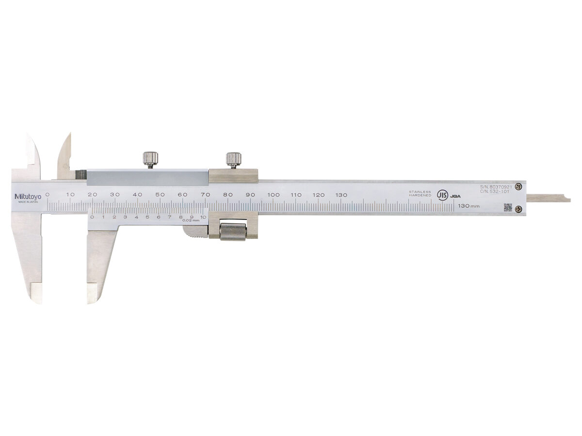

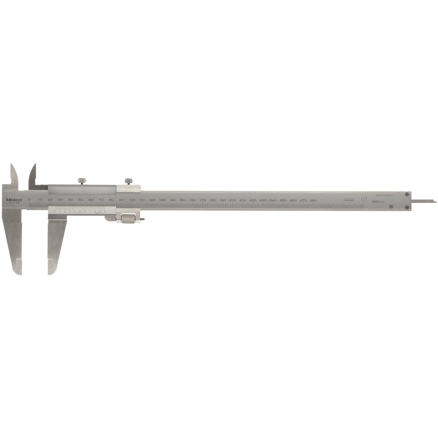

Vernier Scale Caliper with Fine Adjustment
The Mitutoyo Vernier caliper features a fine adjustment carriage to precisely control the movement of the Vernier scale for highly accurate four-way measurements.
View Dimensions
The Mitutoyo Vernier scale caliper with fine adjustment carriage measures outside and inside dimensions, along with depth and step, with high precision and control. The carriage feeds the slider finely for exceptionally precise measurements. The Vernier caliper’s 14-degree face angle offers easier reading and helps prevent parallax error in the measurement. The scales are raised to slide easily and protect the graduation markings. The Vernier caliper with thumb clamp is constructed of stainless steel that is corrosion resistant and has a satin chrome finish which reduces glare.
  • Available in Metric and Metric/Inch models
  • Inch and Metric/Inch models have dual reading scales on Vernier
  • Carbide-tipped jaws are available
  • The caliper is constructed of corrosion-resistant stainless steel
  • Lock screw holds the sliding jaw position to obtain accurate measurement
  • Supplied with a vinyl holster in a fitted carton

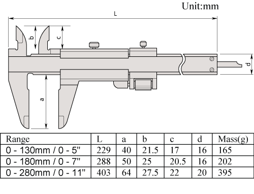

SERIES 532 Technical Data
Technology: Mechanical
Order No.: Product Image: Units: Range: Accuracy: Mass: Graduation: Graduation Lower Scale: Graduation Upper Scale:
532-101 Metric 0-130mm ±0.03mm 165g 0.02mm - -
532-102 Metric 0-180mm ±0.03mm 202g 0.02mm - -
532-103 Metric 0-280mm ±0.04mm 395g 0.02mm - -
532-119 Metric, Inch 0-130mm / 0-5" ±0.03mm 165g - 0.02mm 0.001"
532-120 Metric, Inch 0-180mm / 0-7" ±0.03mm 202g - 0.02mm 0.001"
532-121 Metric, Inch 0-280mm / 0-11" ±0.04mm 395g - 0.02mm 0.001"
